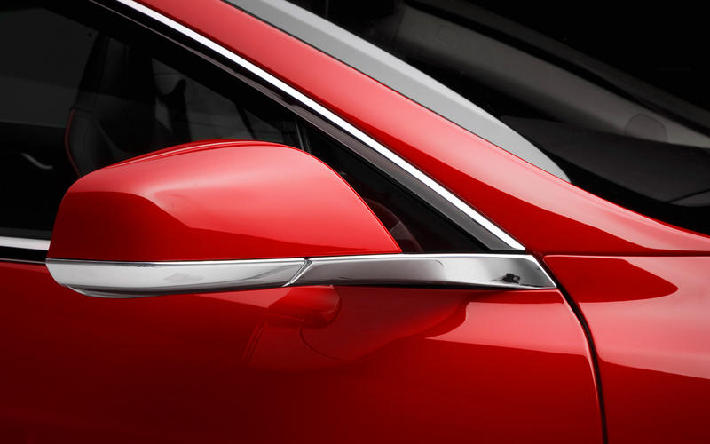

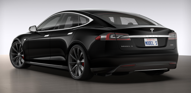

I have a customer wanting to wrap the chrome parts of the door handles, trim and mirrors on a new Tesla. They want to change all the chrome trim around the windows and at the bottom of the doors to black carbon fiber. Does anybody have experience wrapping the chrome trim on this car or others?
My concerns are....will it hold up for very long term, will it ruin the chrome when removed?

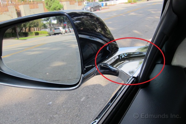

Lastly the chrome on the mirrors looks impossible at a glance...

I have put vinyl over chrome and it's stayed there many years and brand new chrome underneath. Just don't overheat especially if it's plastic. Other then that GFL with that side mirror joint.

Chrome window surrounds
Not usually to bad except for the rear quarter window, can be tricky to tuck into the rubbers there. Mini squeegees will be your friend in those spots.
Handles
like any other, Front in one piece with joins on the back for the second piece.
Mirrors
Should be able to put joins underneath each section. Does have the annoying colour that needs to be wrapped righ under the actual mirror glass.
