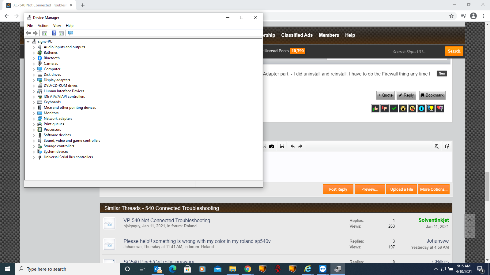

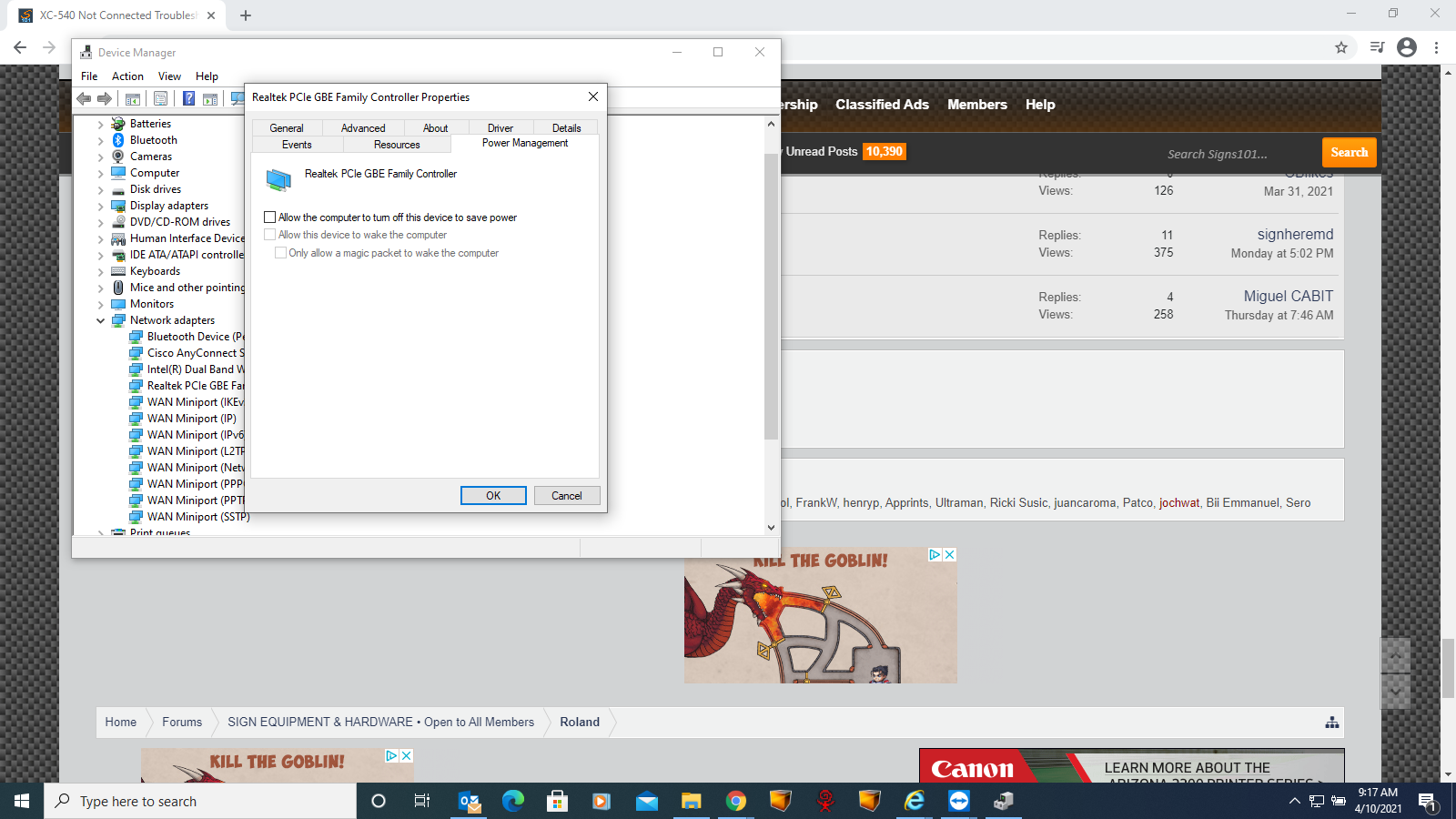

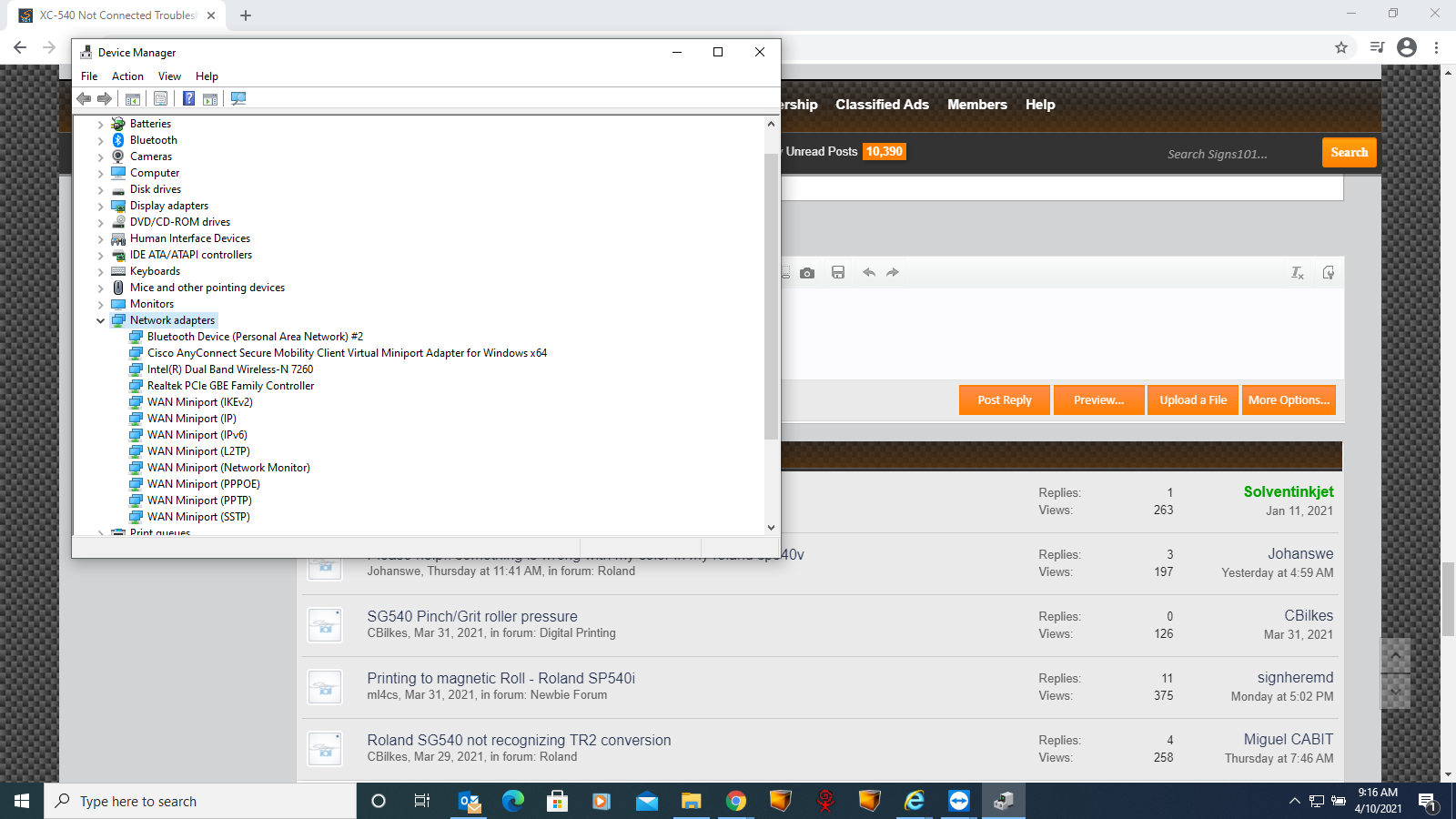

windows 10?
type device manager in search
when you open it go to network adapters
netsol
i am assuming this is the issue
microsoft has lost their senses when it comes to power management
