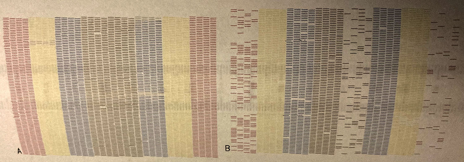

Hi guys, I'm very new to this domain of printing, just three months into this business.
I can't get hold of a service technitian right now as they are still in holidays and can make it earliest next week.
Our XF640 doesn't get all nozzles. First, in the middle of a job I noticed that all the supposed black in the print turned more and more into blue, so I stopped the job.
Black Nozzles mostly gone in Head B.
Here's what I tried since then, in this order:
Normal cleaning, like 10 times.
Manual cleaning, followed by many medium cleaning programs.
After nothing worked, pulled the ink back out of the heads. Didn't work.
A light choke cleaning. Many normal and medium cleanings.
Soaked the heads overnight in solution. No change at all since yesterday.
Here's where I currently am. Thanks in advance!

Thank you guys, I should've added that we are located in Germany. But we solved it. Changed three dampers in one head and one damper in the other just to be sure. Then drawn the ink with a Y-syringe from the capping stations. After many repetitions of medium cleanings and waiting all nozzles came back eventually.
