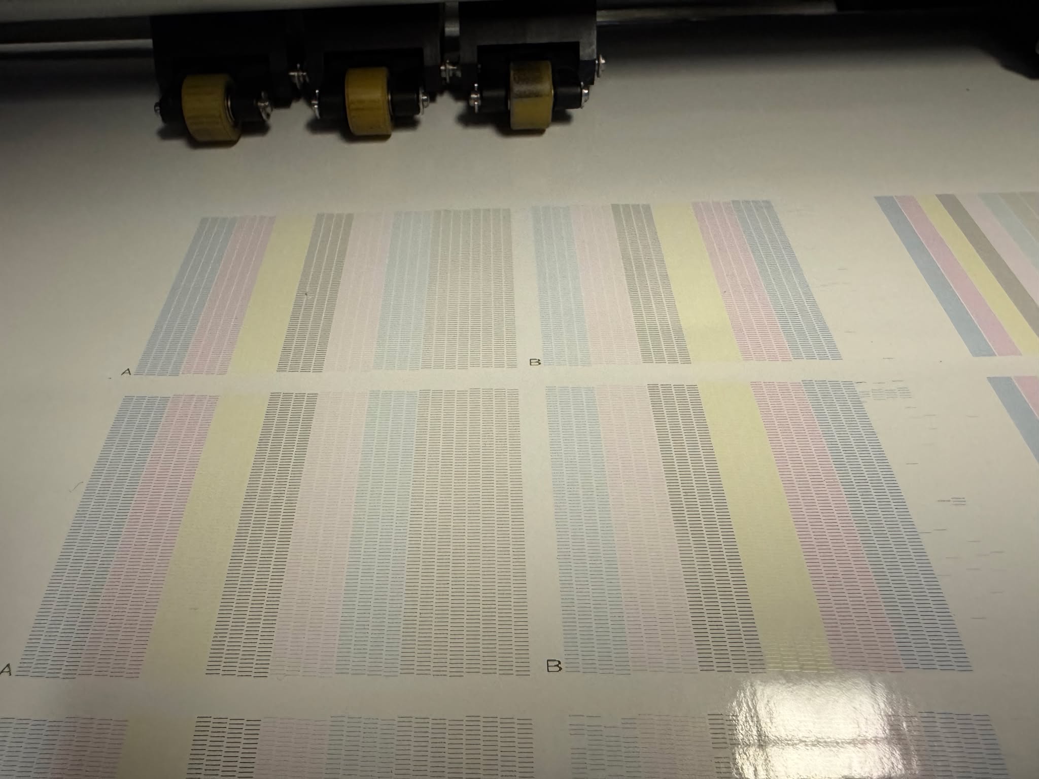

Hey Guys,
So I got this problem where all the nozzles are doing fine but the last to rows are not. Could this be the captop not sealing correctly on the right hand? Or is that the cleaning nozzles that have som junk in em?

Most likely not the cap top, as all the other nozzles are printing fine. You can try a 48 hr head soak to see if it improves any. You can also try changing the cap top afterwards if it's been a while since the last one.

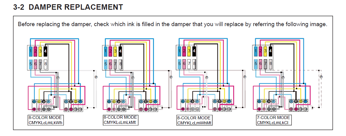

* When using this machine with 7 ink colors (cyan, magenta, yellow, black, light cyan, light magenta, and
light black ), one dedicated cleaning cartridge (ESL4-CL) for ECO-SOL MAX2 is required. Which config. are you using?

Every once in a while, you may see some color where the cleaning cartridge prints on the nozzle test print, the far 2 right sections. If that is the case, you might want to look at replacing your captops and performing the cap height adjust. This style captop should be replaced every 12 months at the least. Heads are expensive, captops and minimum weekly cleaning are worth the investment.
