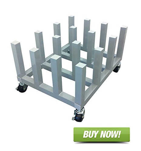

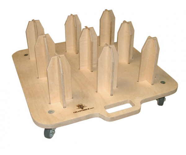

I like those, but they're pricey. But I just don't like the whole idea of poles to wrestle with while grabbing a roll of vinyl, holding the roll, sliding it off the pole......it's much easier to me with the vertical racks we have....but you don't want that so....
No extra stuff...grab the roll and put it in the machine. And these are way cheaper.

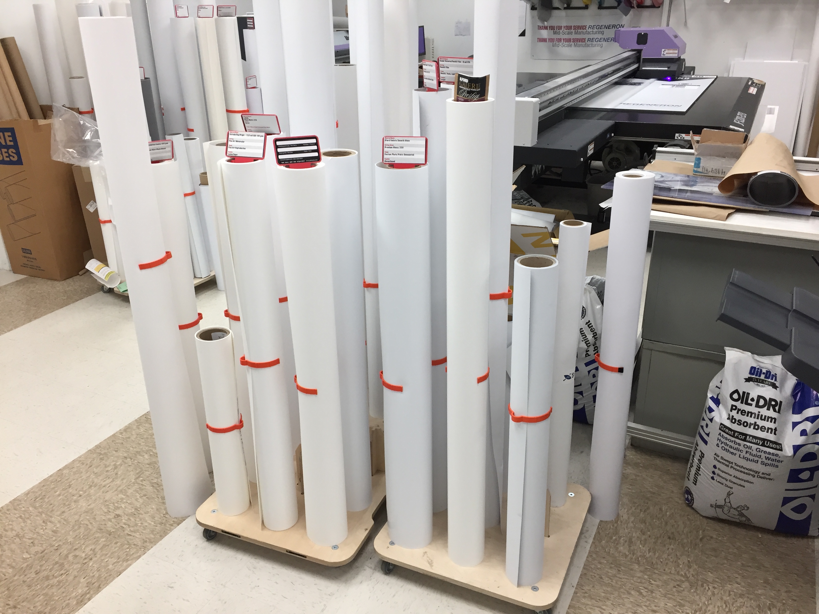

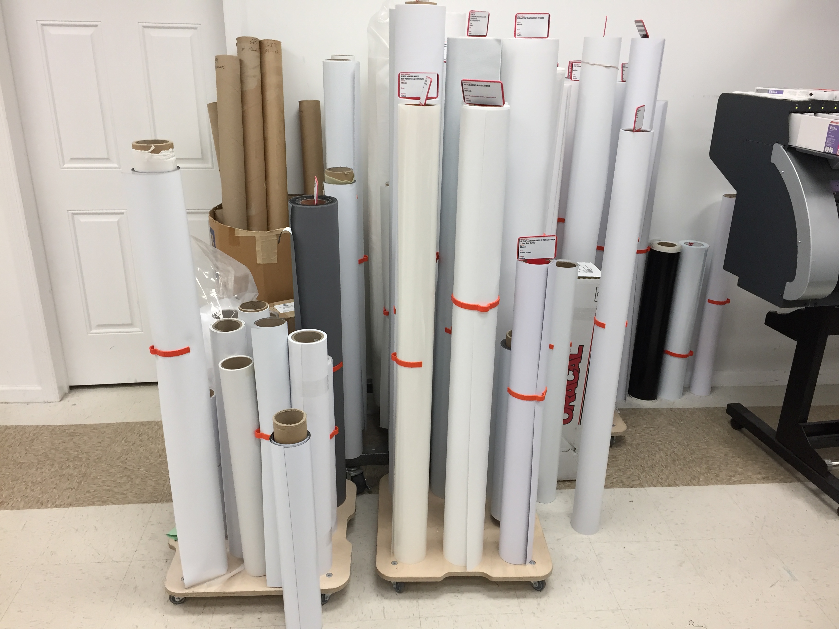

We made this almost exactly ourselves. Couple sheets of plywood, castors, and some 2x4's. works great and can make them to fit your space. We have a 20ft wall lined with a few that we made, as well as a 3 tier aluminum rack with small 15"-24" rolls stacked on. Works great and MUCH cheaper than purchasing something like those.

I'd love to see photos of your racks. Thanks for the feedback.

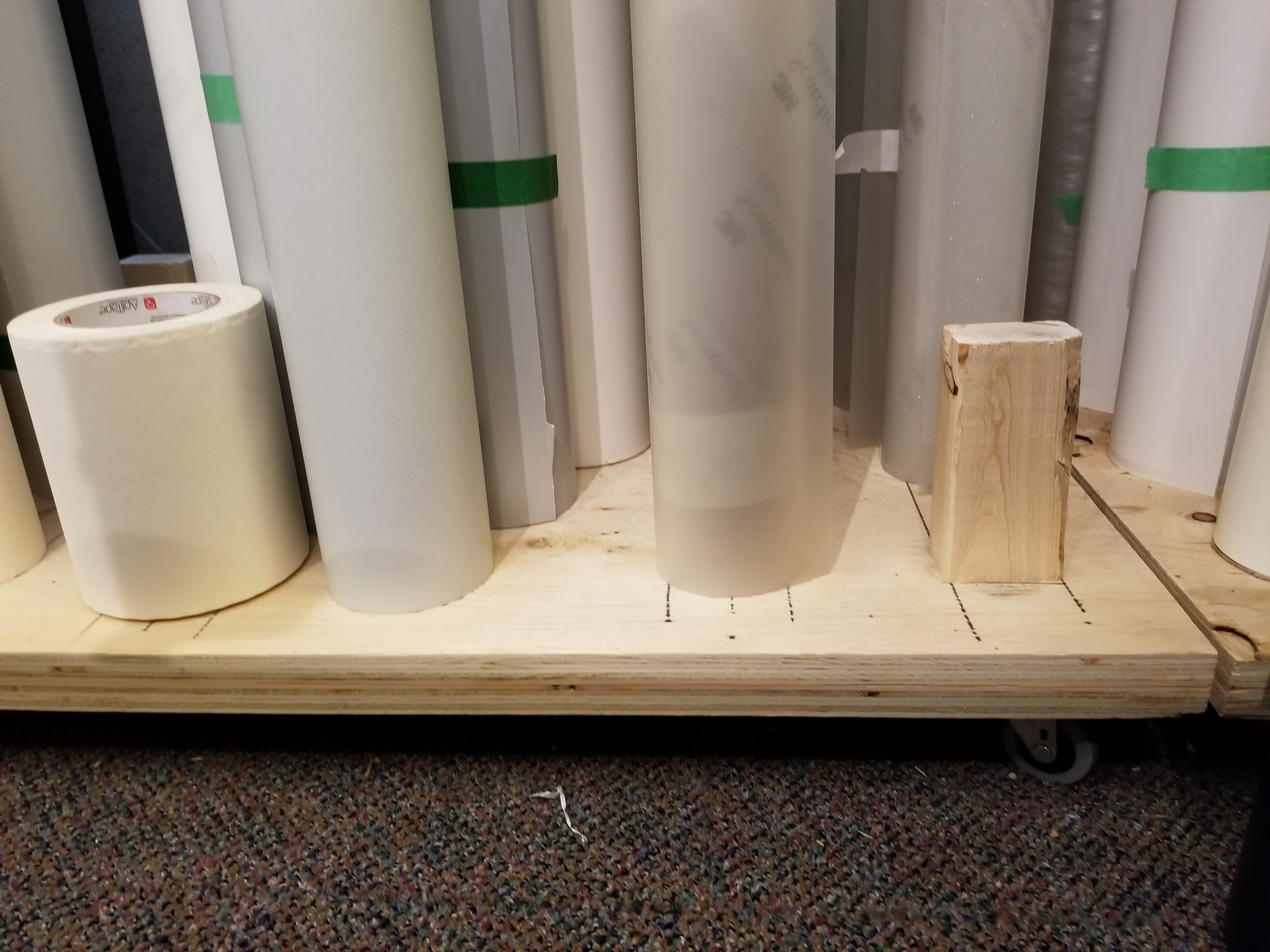

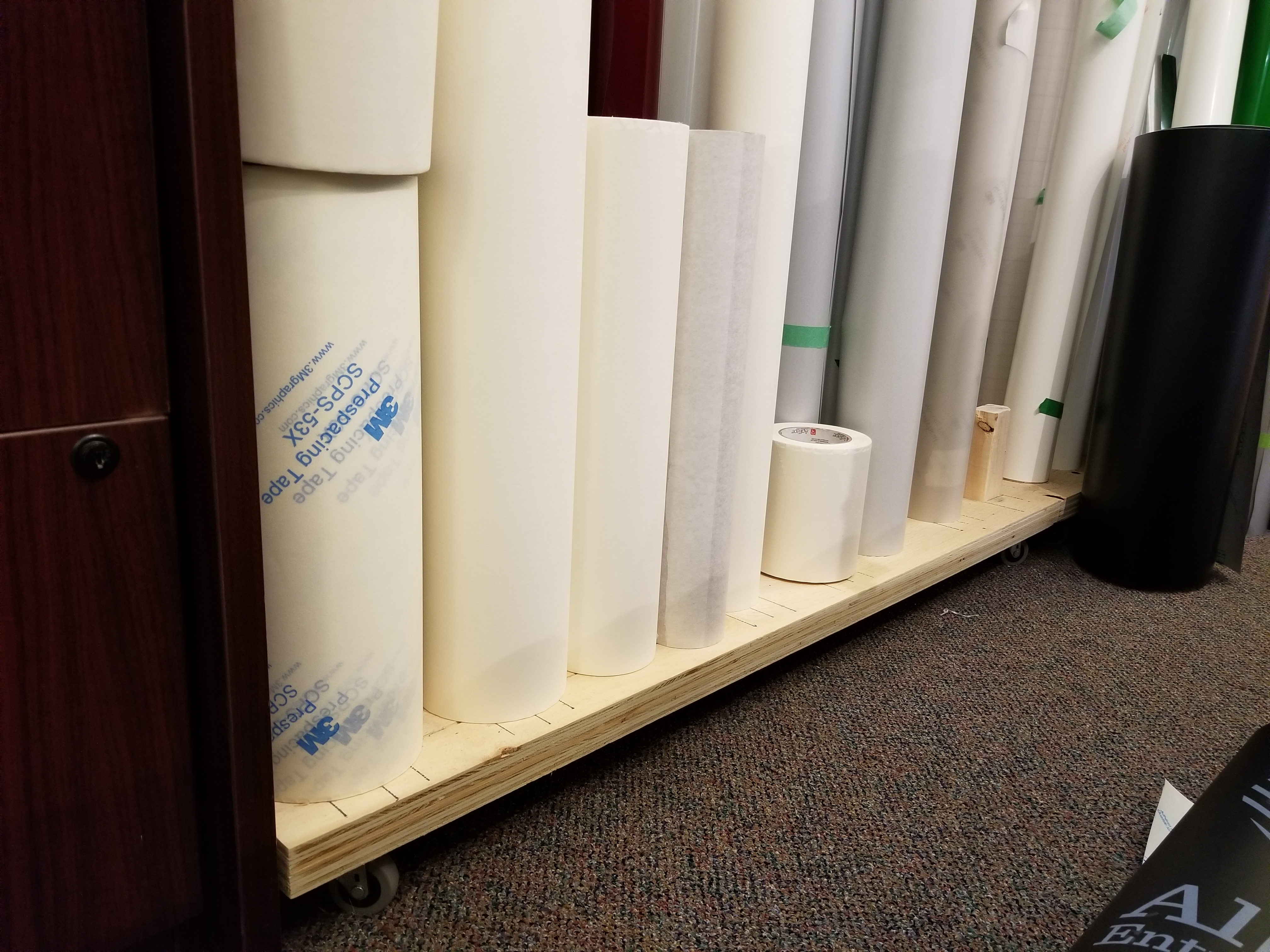

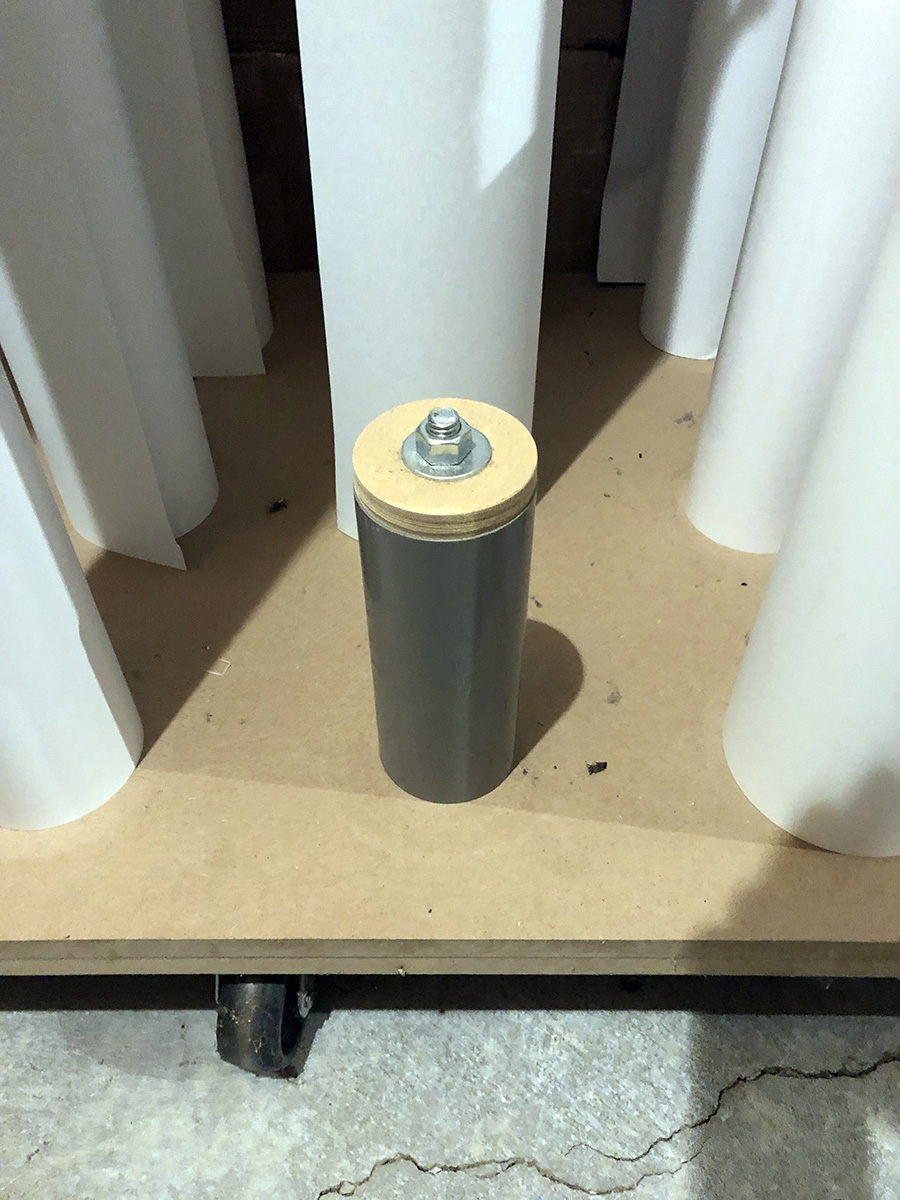

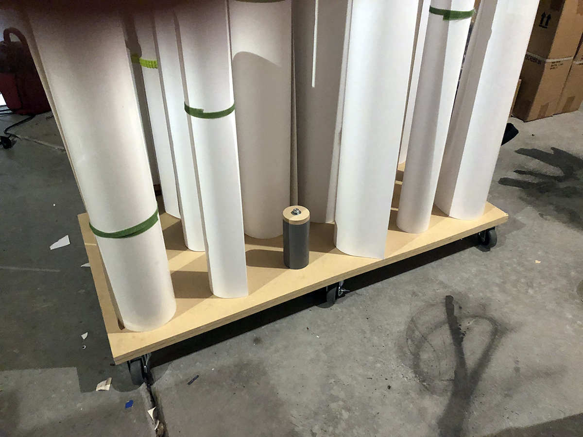

Center poles are a pain in the proverbial, especially with wider rolls. Go vertical and make your own racks, very easy - casters, MDF sheet, PVC tube, nuts and bolts.
