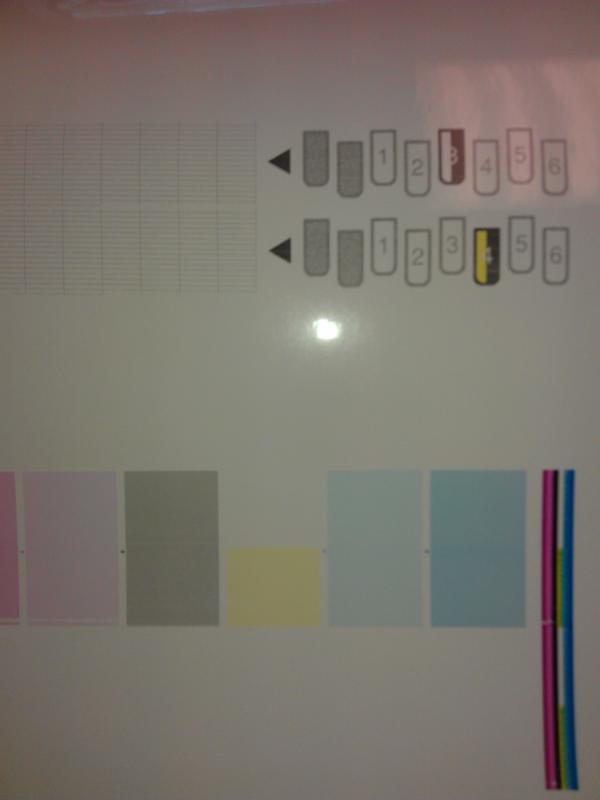

GP
Is that a separate process somewhere? Don't see it on the LCD menu.
Do I just fake it out as if I were replacing the PH - and let it run it's automatic printhead alignment after I 'replace' it?
GP
Though the status check via Supply function / IP address says that all printheads are okay - this test print may reveal that PH # 3 (y/k) may not be shooting yellow, no?
Wish I knew how to read this damn thing...

jayhawksigns
Same head as mine, just a different color. Nice thing about these printers though, the heads are so easy to change.
