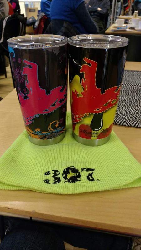

I didn't snag pics as it was a late at night with a few adult beverages involved. It was for a good friend for his grooms men. I will see if I can get a few pics from him when he gets back from his honeymoon.
Get Lucky
Picture as promised.

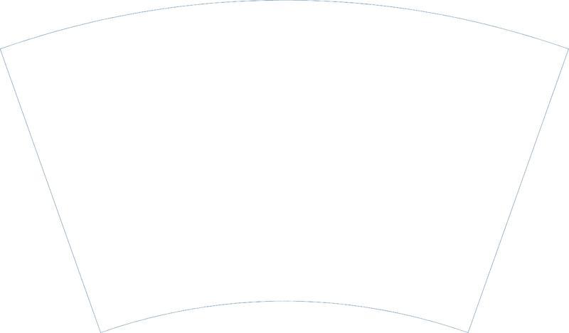

Making a template is waaay easy. This goes way back to drafting class and conical development, but it can be simpler than that.
Put a straight line on a large piece of paper. Place a piece of tape on the inside edge of the cup's rim and put a mark on it. Place the cup on the piece of paper so the mark in the cup aligns with the line on the paper on the table. (In essence, the mark will be at the 6 o'clock position.)
Roll the cup on the table so it makes one full revolution (the mark will be back at the 6 o'clock position again) Since it is conical, it will make an arc-shaped pattern. Note the major radius and the minor radius and the included angle. The included angle is the angle between the first line drawn on the paper, and where the cup stopped after making one full revolution. There really shouldn't be much of an issue if the cup is slightly convex.
So...if you're still having a hard time visualizing this, go to McDonald's and order a drink that comes in a PAPER cup, not one of those bladder-busting plastic cups. Gently unroll the lip at the rim of the cup and separate the vertical seam and remove the bottom. Lay it flat on the table and note the shape...that's what you're after with the Yeti cup.
