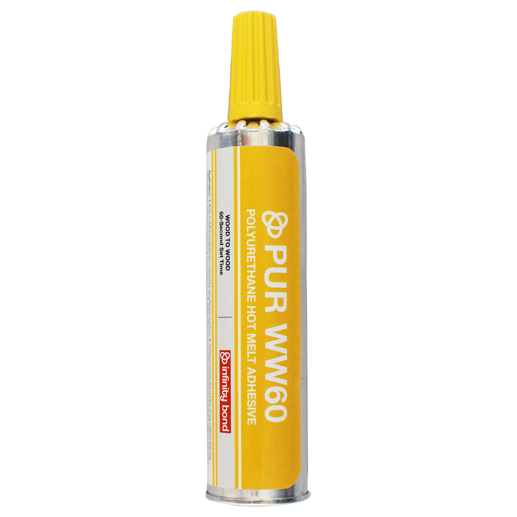

We have used this to repair and replace belts in the past. Seems to work pretty well.
