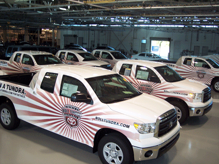

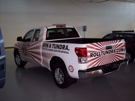

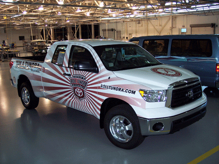

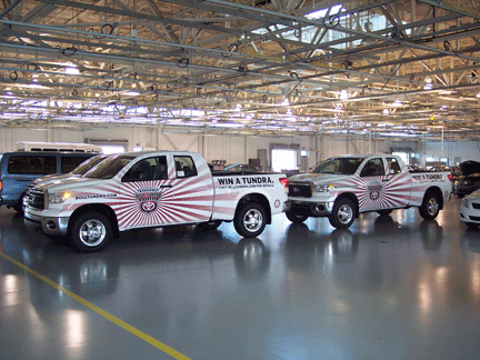

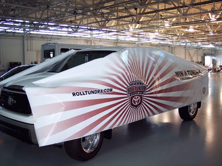

A suprise deadline caused this. I had planned more time, however the client had different plans. Completed all 10 tundras on-time! This, by the way was the smoothest install I've ever done. The process was, align & attach the sides on all of the trucks first.(see photo of complete panel for the entire side) Then pull the backing on all of the sides. Adhere and trim sides, Driver then Passenger...next truck, Driver then Passenger...next truck and so on. Apply hoods all in a row, then tailgates and BOOM! they're done.
2 - 12hr days, one guy....Tazmanian devil style.

i love one peice sides. i wish we could have done it on our sprinters. you can litteraly lay a passenger car in one hour both sides hood and tail. this is why we are buying all new 64" printers. with the volume we are doing, its the only way to go due to the time savings.

As to the single-sided prints, I print all of mine that way (Except Box trucks & 53' trailers) I definetly recommend doing your next sprinter lengthwise and split it at the deep groove in the middle of the sides as well as from the drip rail up over the roof! This way you'll only have 1 seam to worry about
