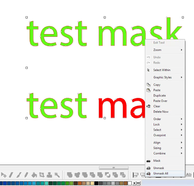

Where is unmask all in Flexi? I only see "Unmask"

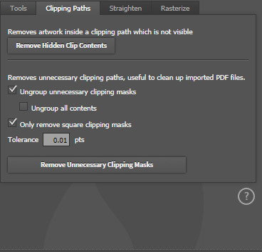

ikarasu
I get this a lot when importing pdf files -I dont know why pdf likes to mess up and add a ton of clipping paths it doesn't need. I use a script from powerscript - I believe it's $15.... It's paid for itself a dozen times.
https://o2creative.co.nz/shop/FixIt_PowerScript_for_Adobe_Illustrator
I purchased the package for $40 -
https://o2creative.co.nz/shop/Power...and_Edit_Script_Package_for_Adobe_Illustrator
The dimensions script is nice for proofs/etc.
bannertime
Sorry, I just got back here. Attached is a screenshot. Next step is deciphering which path to keep and which to delete.
I'm assuming that it's a bunch of gradients or something behind all the mask. Which will be a nightmare. Best bet is doing it in Illustrator or whatever native program they used and exporting it properly.

Evan Gillette
Like bannertime said, right click unmask all, then use select by attributes ( shortcut is "d") to selct the black rectangles and delete...its not going to be fun but cross your fingers and hope it works
