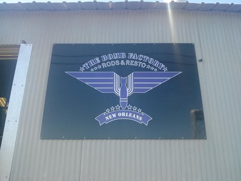

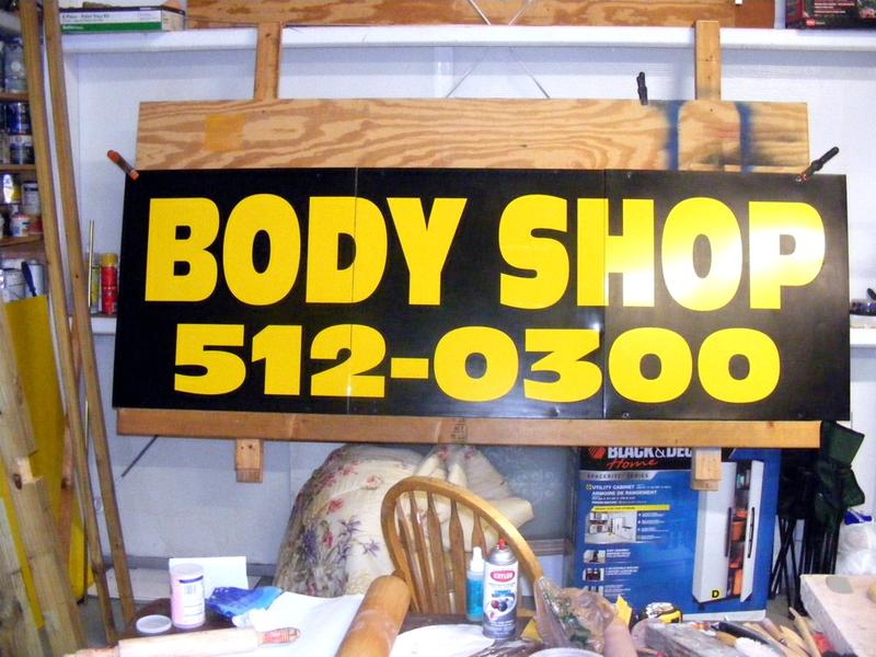

OldPaint
since it is a body shop......and they are gona paint it, why not use ALUMICORE? or .40 4 ft x 10 ft sheets, cut a foot off each sheet now you got 6 foot X 10 foot center seam. going on a metal building........can just screw it to it....or make it stand off a little with sq alum stock 1-2" or 3/4 X 3" wood.............
Why don't you want fasteners visible ?? You want the illusion that it's hovering in midair with magic ??
Recently, there seems to be an over-abundant amount of people trying to eliminate the most logical way of installing signs. Everyone seems to want to use some glue or double sided tape. What is so wrong with fasteners showing ?? It hasn't been a problem for 100 years, but suddenly, all these people with little... to no know-how, want to change things. Why ??
Being creative with physical fasteners is a very small challenge in the scope of things, but can add beauty to the overall finished product if done well.
