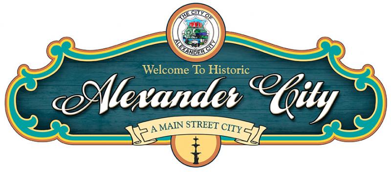

luggnut
sign pic
here is one sign i'm quoting it is supposed to be 4' x 10.5' the other is a rectangle 3x11...
if i can't hide a seam i think i may try to convince them to go with 10ft (if they make 10ft HDU) they would like a sandblasted sign so HDU may be my only choice.

For the glue joints, we always go back in with a knife or chisel and take the glue joint down to where it looks good. No one ever sees that part afterward.
