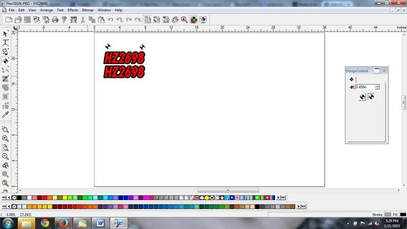

If you use Flexi you can either use the auto registration mark in production manager, or do like I did in the picture put your own registration marks wherever you want to.

Another thing I was going to mention when doing multi color decals with registration marks it is a lot easier with clear transfer tape.
