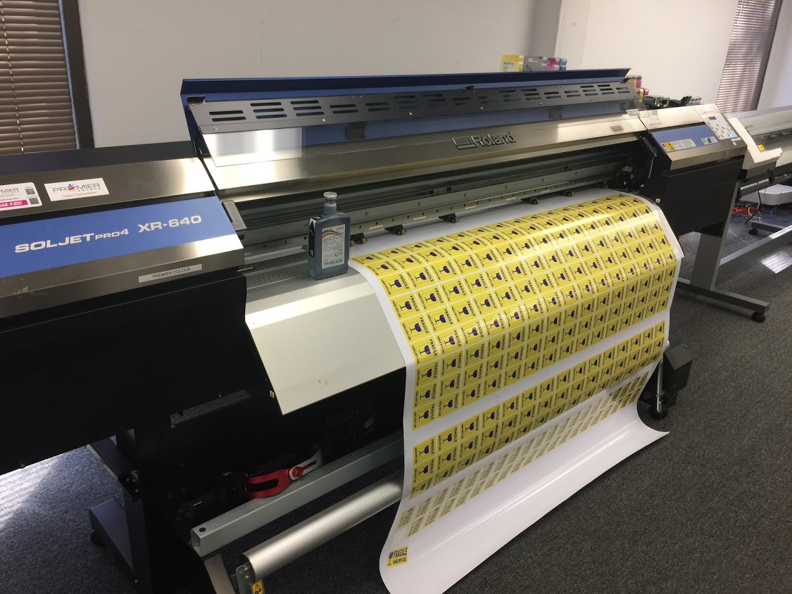

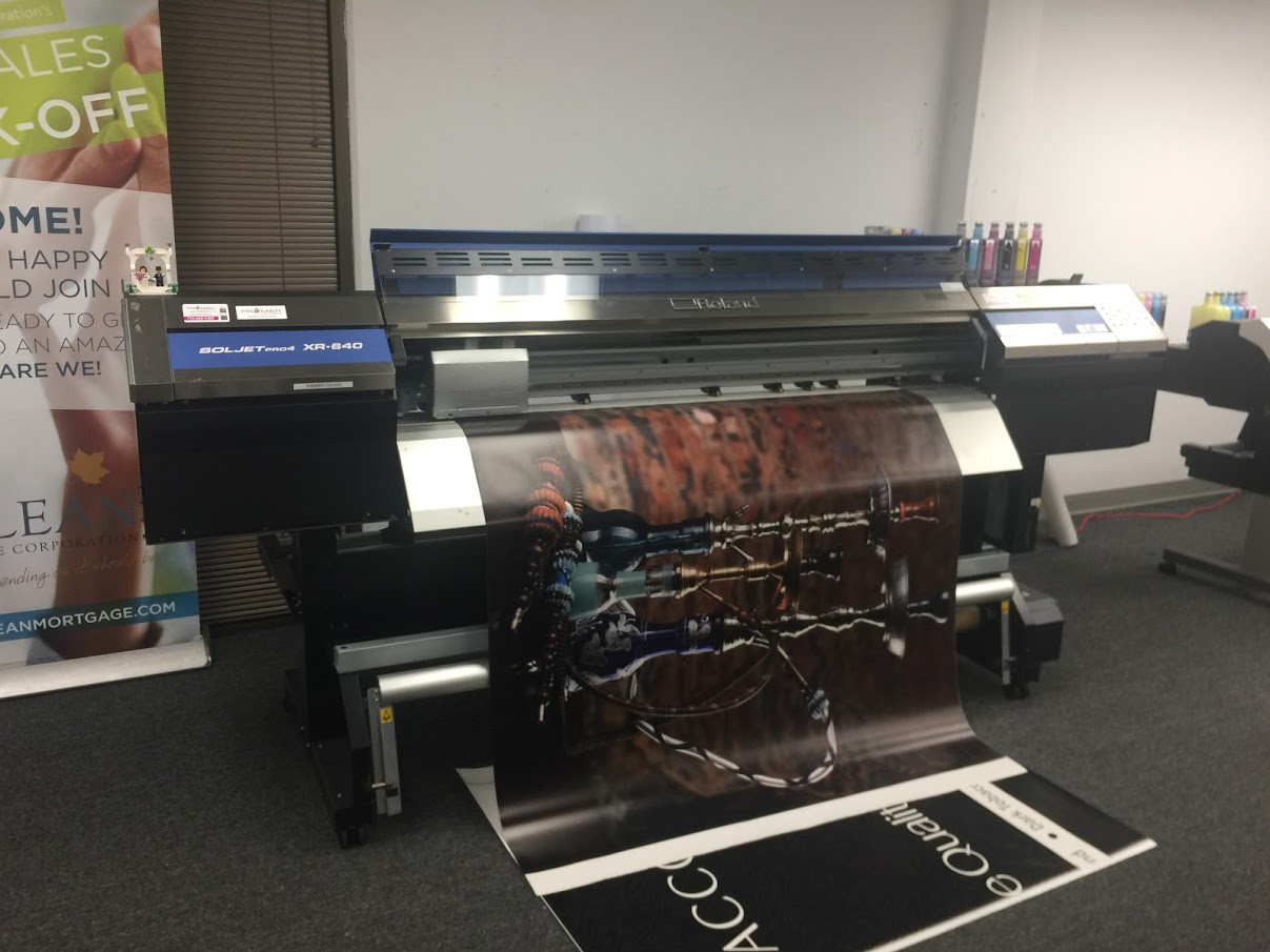

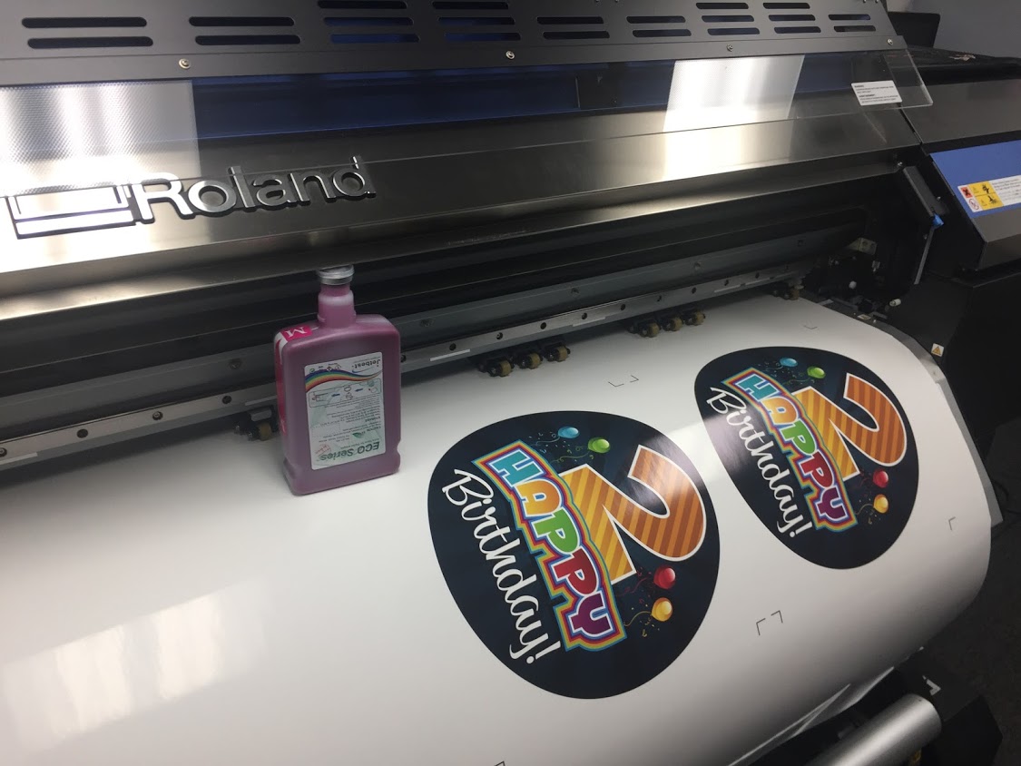

We are a merchant member selling ink supplies. We purchased a brand new XR640 using Jetbest ink on the first day. Never an issue.
https://www.premiercolour.com/colle...t-max2-440ml-for-roland-printer-xr-xf-rf-vs-i
How are you printing borderless on that Roland? Or was the print just inserted back in for the picture?
