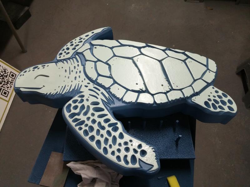

Ian Stewart-Koster
Older Greyer Brushie
We can convert 2D vectors to 3D reliefs, but I'd also be happy with $2500 for the job...
Be aware, that a 3D file can take AGES to rout, while a 2D or 2.5D file is relatively quick in comparison.
You could also do a bit of fabrication- a 2.5D vee grooved file of 3/8" thick HDU, glued over a domed or shaped 3" styrene underlay...
In fact you could freehand that with a hand-held router and a couple of rasps too, and fabricate it, and have some fun in the process.
