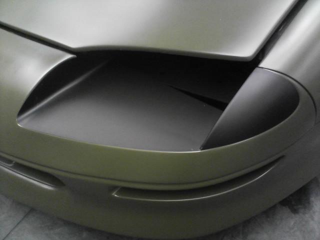

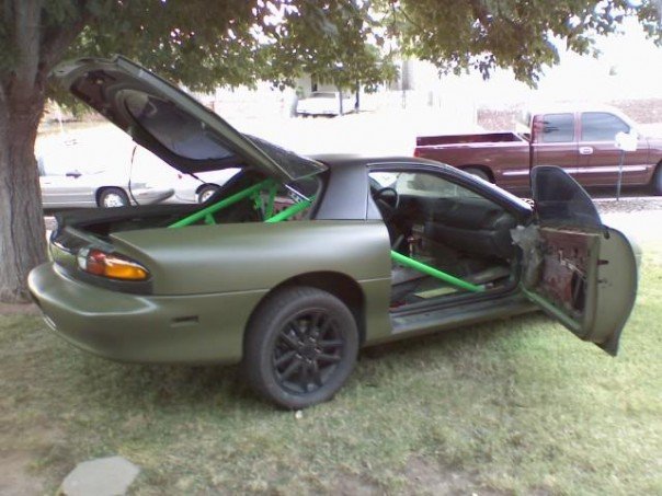

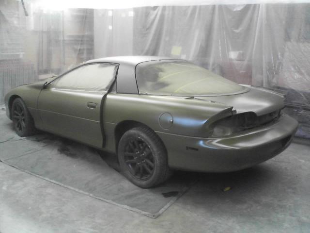

Here is my camaro it was painted Urban Green (04 z4 bmw)
We added a flattern to the paint.

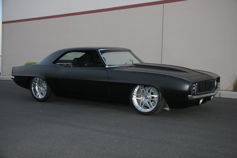

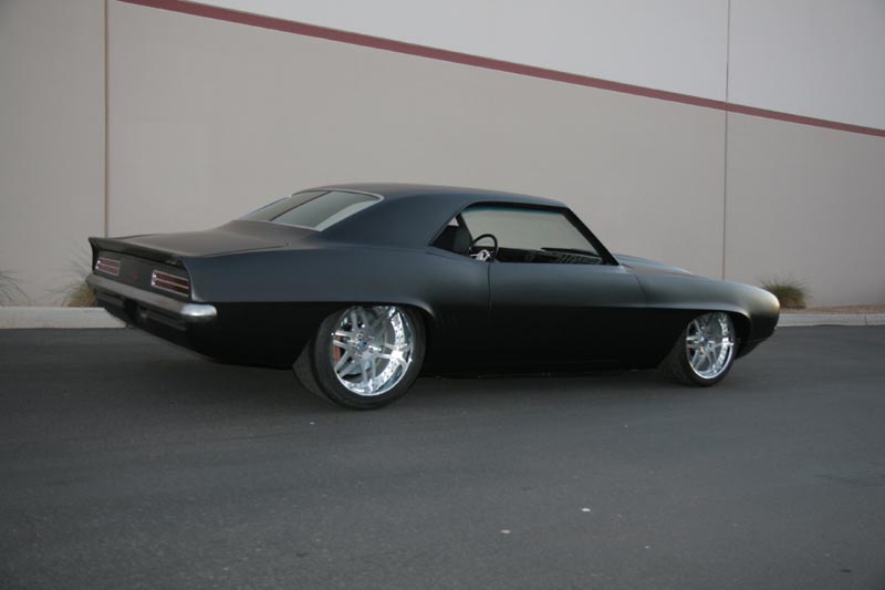

for a newer car I would say wrapping it would be the better way to go. To correctly paint the cart paint would cost more. When I say correctly I mean removing tail lights, mirrors, door trim, window trim, and so on. From the sounds of the project it seems they would not want the cars to be flat forever. Seems to be more of a trendy thing. Don't get me wrong. I think it looks bad a$$ on the right car. Going flat or satin requires a lot of TLC.. if the paint is not taken care of it will look like crap fast. If you rub on it too much it will make a little shiny spot. It all comes down to what the end user is looking for.
This is an older car, but it looks tough flat. I got the pics from a Camaro forum
