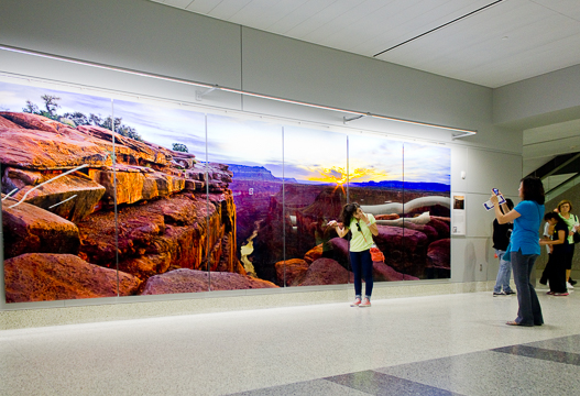

All of the above except when the acrylic FACE is not backlit, when the sign maker knows not to laminate the acrylic FACE, when the sign maker knows the marketplace, when the sign maker knows that customers may drive their market, and then knows how to actually manufacture the product competitively or not, remembering all the while to continually educate himself and his company.

Why not laminate the face? We do it all the time for backlit signs and non-backlit signs on acrylic. Acrylic is a damn good substrate that isn't as prone to warping as 3mm ACM or PVC and routs to shape beautifully.
...and $700 on a new .177 acrylic face covered with laminated IJ40.
