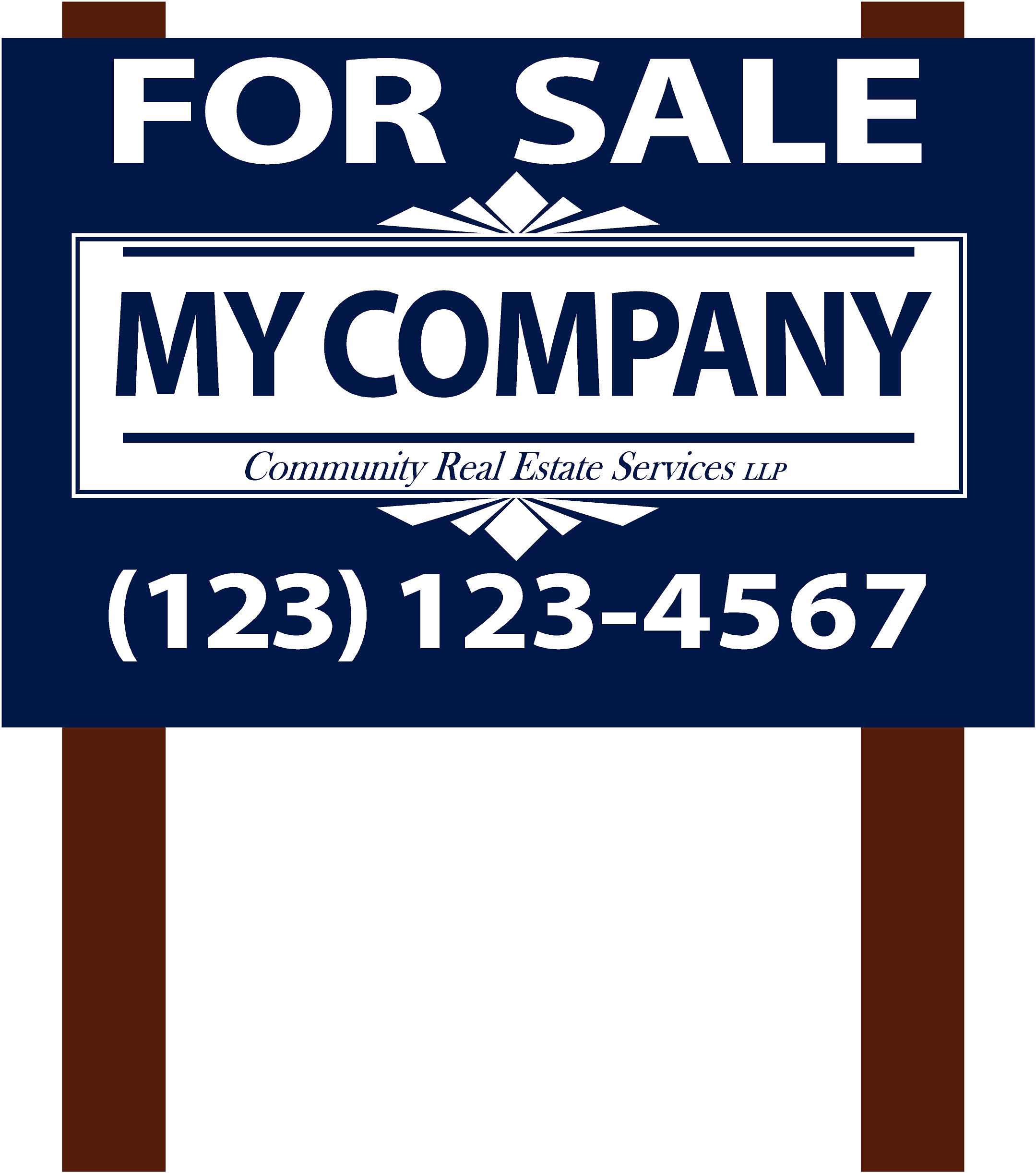

Hi I have an order for a 4'x6' "For Sale" sign. They would like it installed with 4x4 posts. I was thinking of using 1/2" MDO with aluminum sign screwed to it and then 2 posts in the ground (as suggested by customer). I would assume I should put them 3-4' in the ground without cement. In WI. Do I need to do anything with the MDO to seal it? Do I need 2x4's behind on top and bottom for a brace? Thanks!

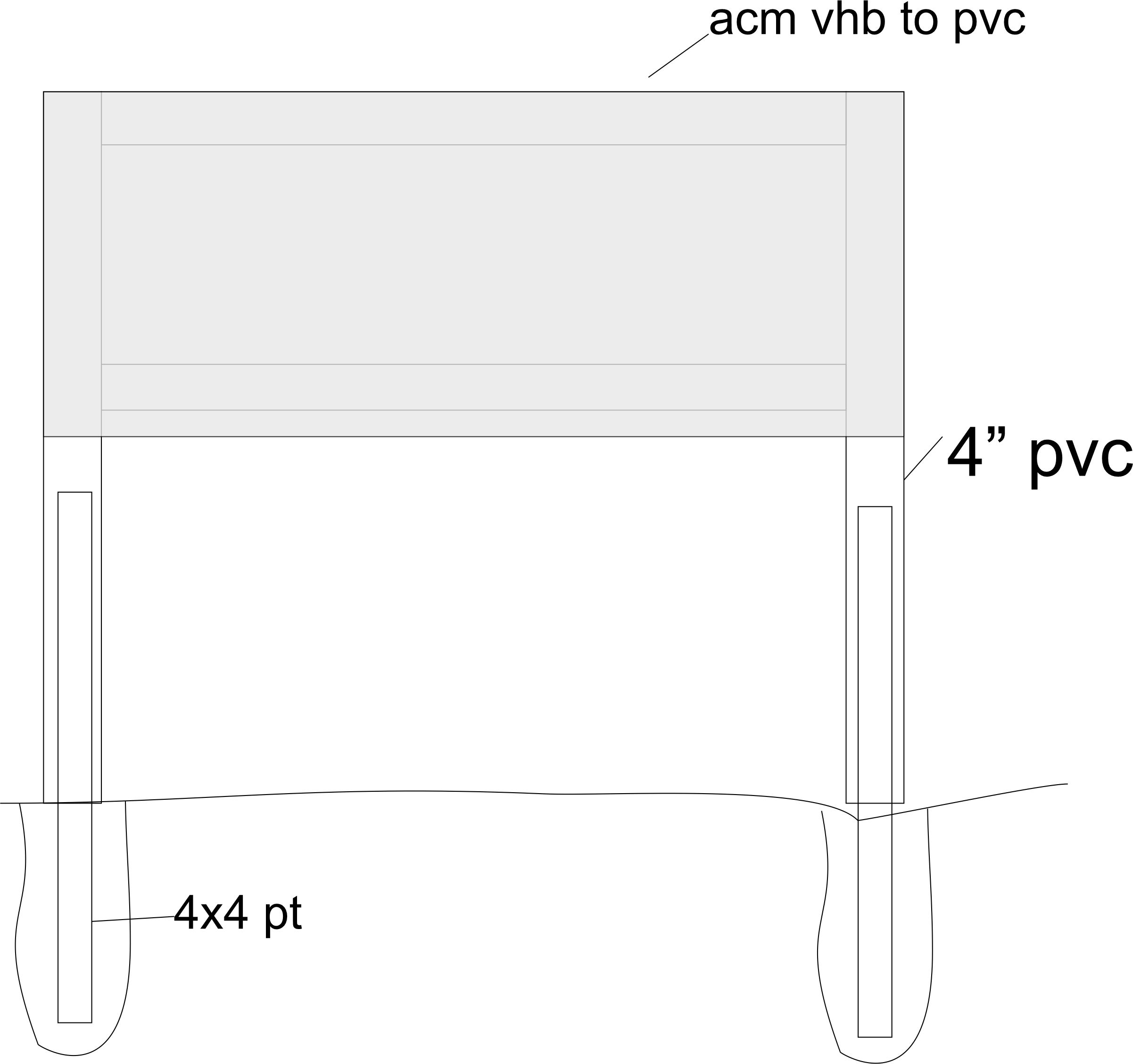

Here is what we do.
It is nice looking, easier to build and much cheaper to make and install.(acm cost less than MDO)
Mdo and wood posts are a thing of the past.

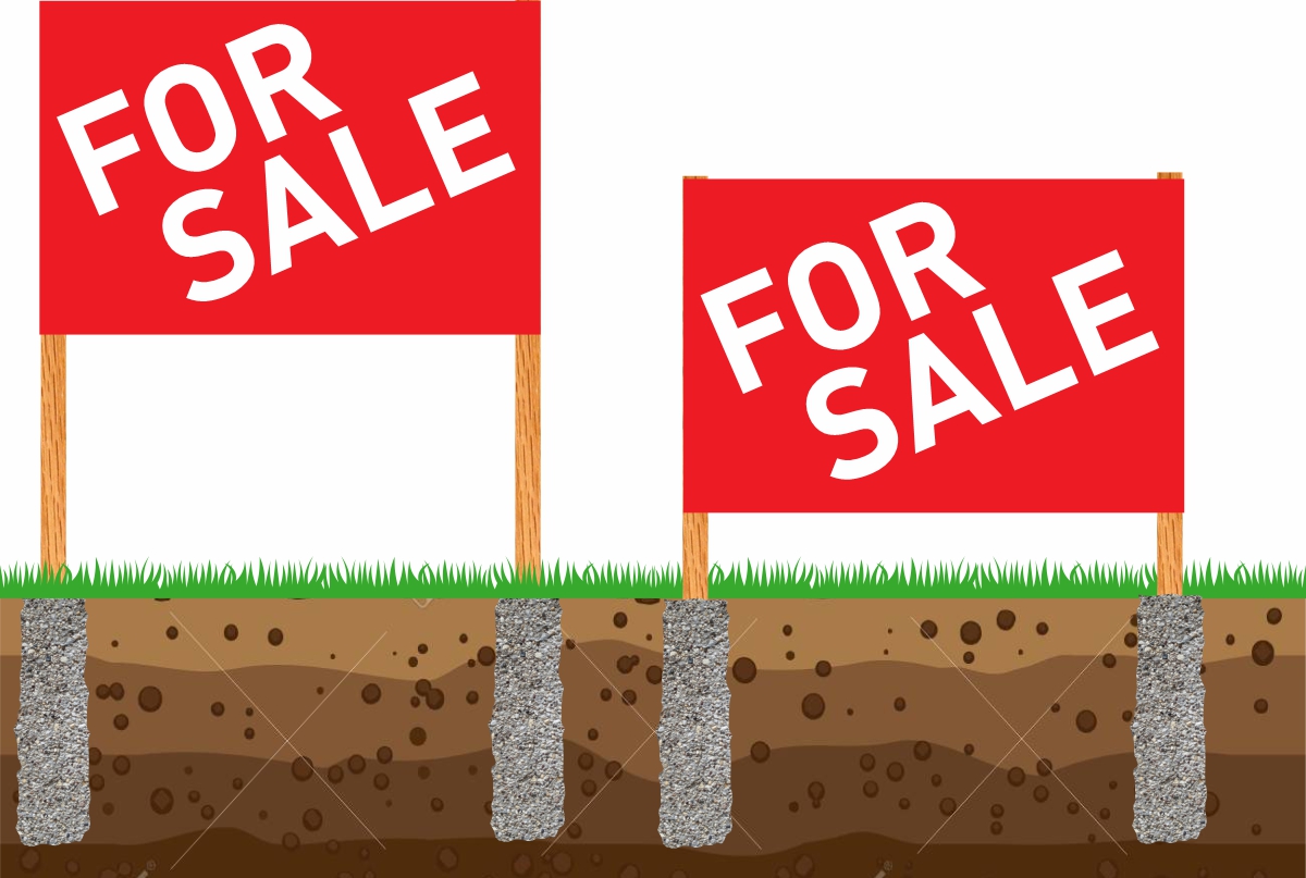

I'm surprised how many use concrete. Fill the hole with gravel and use a tamping rod. It will stay there forever and is much easier to remove when time comes.
That might work in warmer climates, but up here where the ground freezes, thaws, winds, gets washed out by rains and whatnot..... the ground is constantly shifting, causing the sign posts to move. In my neck of the woods, there are so many rocks, they keep coming to the surface and with them it will knock things over which are not securely installed.
