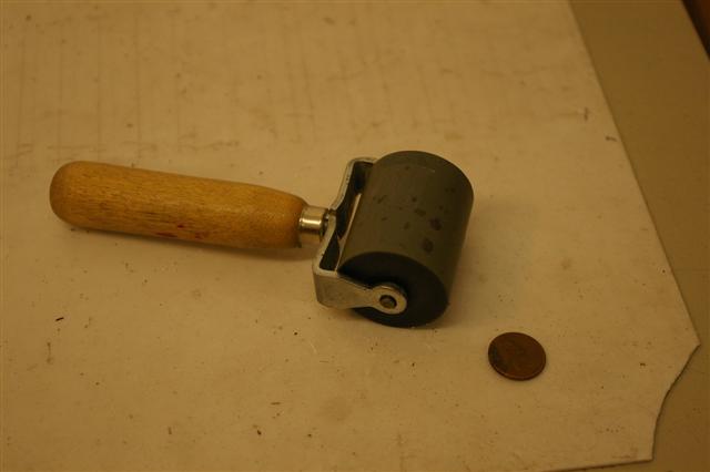

We use a 2" rubber roller for applying vinyl to acrylic or other flat substrates. It won't leave any scratches.

Todd
