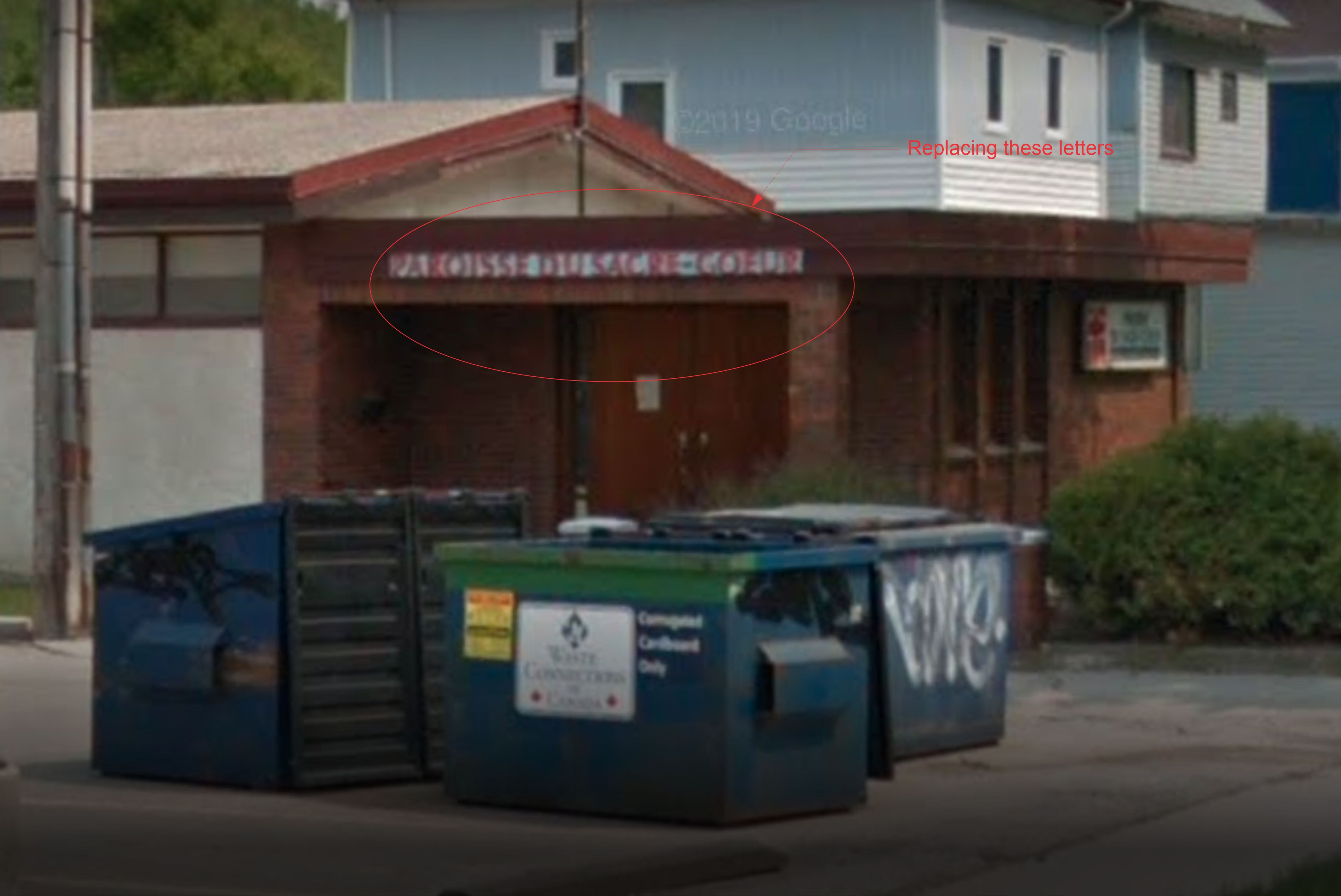

Sorry, I completely forgot to include the part that it is an exterior install. All upper case letters.
Would be mounted flat to aluminum cladding no no ribs/corrugations to worry about.
Pic attached of install location. (Previous letters and cladding has been replaced already)

At 6" tall, tape would be ideal, depending on exterior or interior and of course, ribbed vs acm cladding (which I'd assume it is). You could go either VHB or laminate 467mp then route, skipping tape.

I don't think it would save more time doing that VS drilling. You still have to setup the pattern and peel all the liner off the letters. I like the security of studs on outdoor signs. Studs and Lexal are my prescription.
