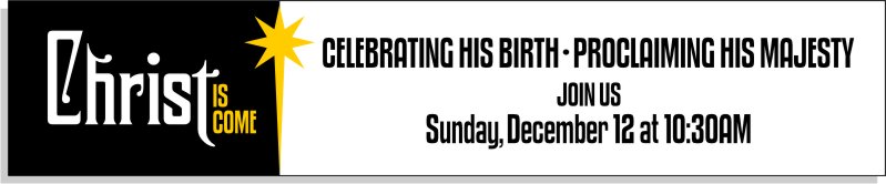

Well, I finally figured out the software enough to put this together. The banner will be 2ft. by 10 ft. Please let me know what you think. Thanks, all!

That's not bad. I'm not sure if it's "proper" but I would capitalize "us" and i would adjust the spacing on the "dec. 12". Also maybe make the graphic in the center just a little more interesting to look at - but dont over do it. If you really want to go for it, use some drop shadows. very light grey. That's my 2 - have a great day!

I like how you used the star to separate the info.
But...
I would not put celebrate on there twice, try "Join Us"
There really is no focal point beside the star, we see text but nothing is emphasized.
I don't like to abbreviate on things if I can avoid it, either.
Here's a very quick suggestion.
On a big banner I try to break it up into panels whenever I can.
And adding even just one more color can help.

WOW! I like that, Jill!! Great suggestions. Amazing what a difference "the little things" make in the look! Skyhigh - I am not ruling out eyelids stuck to chin as a possibility, either! LOL!
