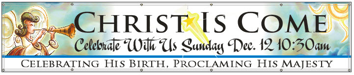

Here is something I put together to show you what a digital print might look like.

Make sure you have enough negative space around the layout. If you're using stock premade banners and you have a 3'x4' banner, then the actual size after hemming is 33"x48' ( if you're using 3' material). You have a 1.5" hem all around the outside, so your actual imprint area is 30"x46.5". I usually start with this imprint size so I know that my design won't go into the hem area.

great tip

As long as you are putting on a Christmas cantata, why not say so? How will I know it's not just another Christmas church service?
