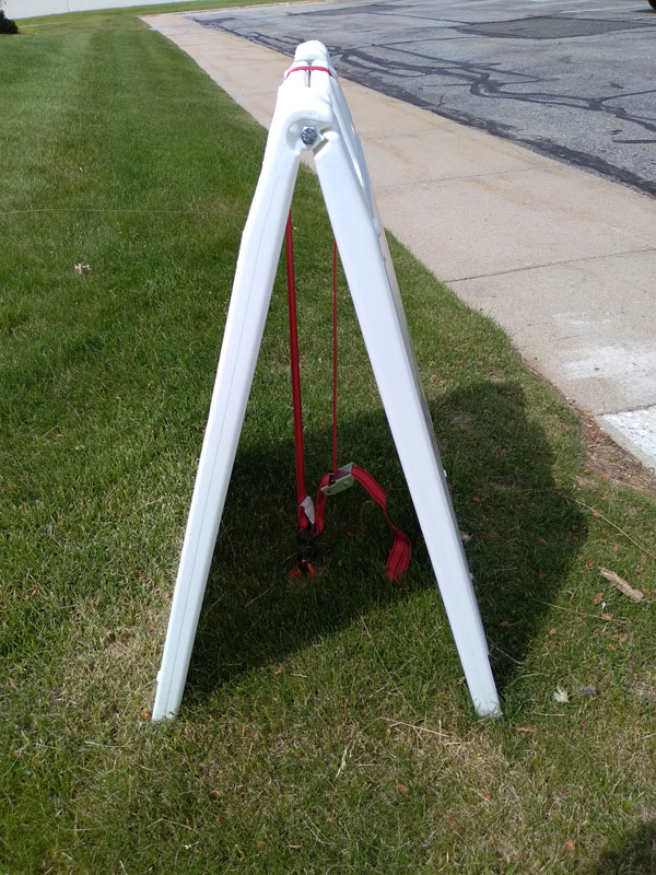

I know you said no A-frames, but I had a customer who said their A-frame kept blowing over. I suggested tethering it as shown in the image, with a ratchet strap and ground anchor. Not sure how that would work once it snows, though.
