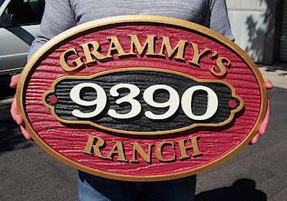

A sweet little HDU sign we just finished
TimToad
We just put the final paint touches on this sweet little HDU sign for a client.
After it was done, I realized how cool it would have looked if we had done the black background of the address in black smaltz.

Love it! Okay, newb question, but how do you get that wood grain effect? My router can etch out pvc signs, but I've never got it to do anything textured like that.

nice. it would have been cool to do smalts on the black. another way is to pebble it as that also looks cool

I would like to know as well, was it routed or sandblasted, sorry but I have zero experiences with those type of signs.

TimToad
most non-basic CAM software for routers can take a raster grayscale and apply depth based on white-to-black gradation
The sign is routed to about six different depths. The photo doesn't do it full justice on all the different planes its working on.
We rarely do sandblasted wood anymore now that the resource is so diminished and the HDU foam is so easy to work with. It takes paint so much better and has far less expansion and contraction.
Redwood trees aren't exactly a plantation kind of crop given how long it takes them to achieve millable size.
The texturing can be adapted to nearly any raster/bitmap image you can feed into the software connected to the router. Our operator has a whole library of wood grains, patterns, etc. that we can plug into a job.
We keep talking about getting Dan Sawatzky's texture DVD, but most customers aren't adventurous enough to bite on anything but woodgrain.
We used Modern Masters acrylic paint for all the gold and even after an acrylic based clearcoat, it still has a really nice metallic sheen.
