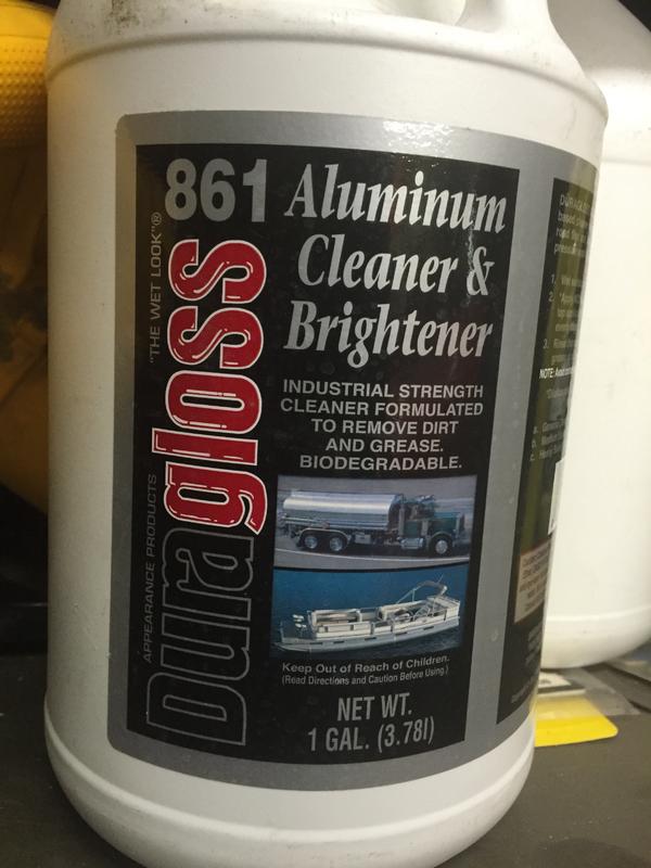

I just cleaned my car trailer last weekend. I use this. Piece of cake, just follow the directions. It's available at most parts stores. I use a pump sprayer to apply.

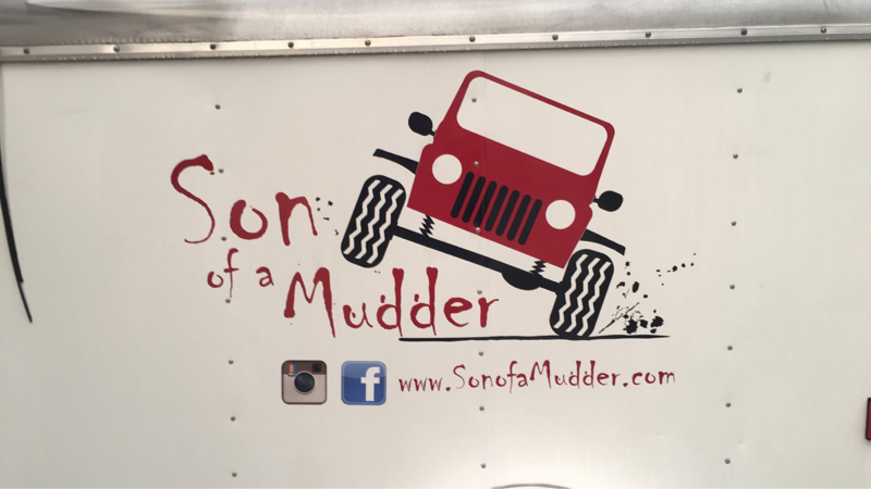

Thanks guys, i used my carwash guy and he got up close and personal with it, turned out well
