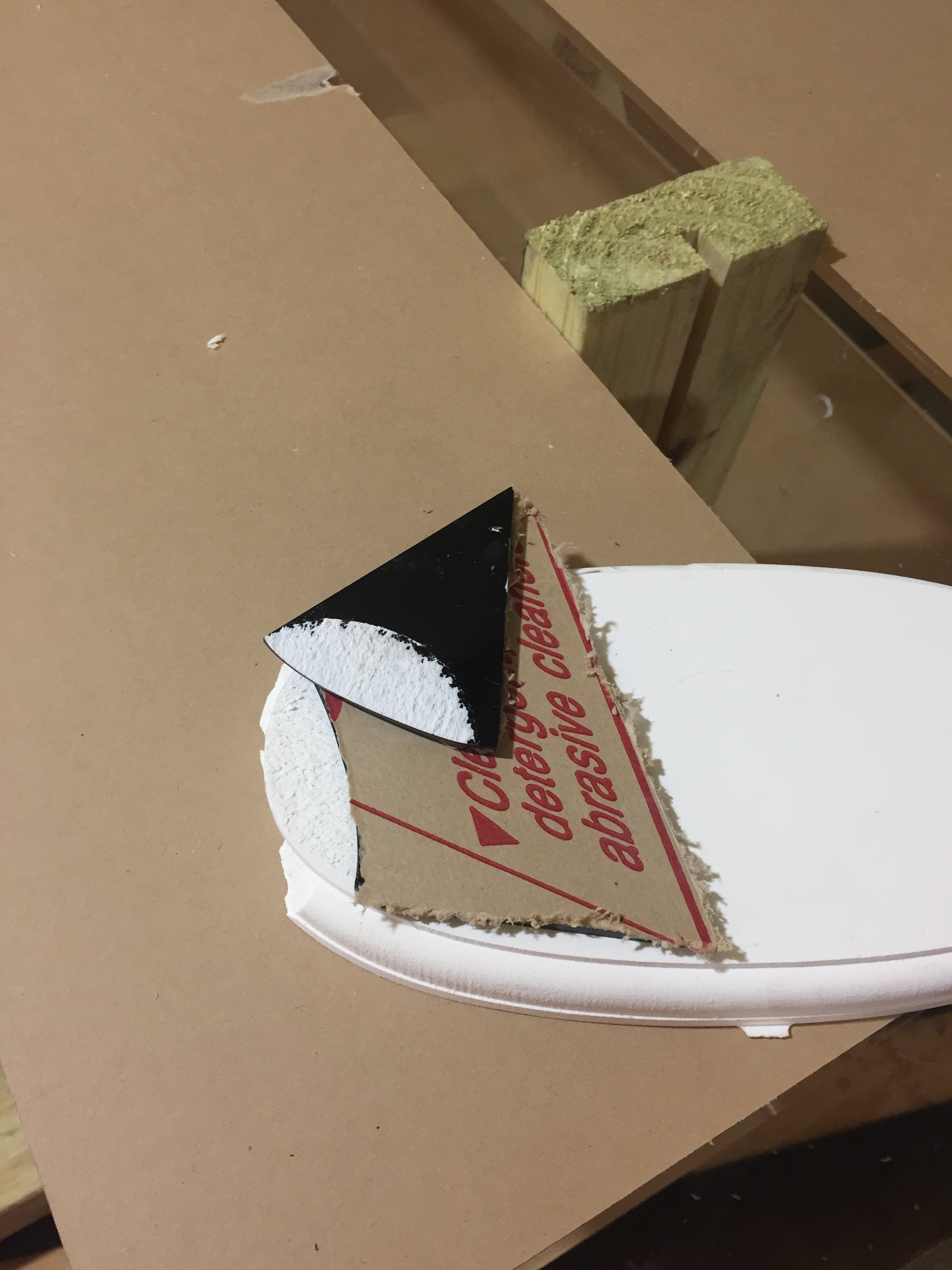

So I really put the Weld On to the test. As the picture shows the materials have chemically welded and it took a full force whack to break off this piece.
I'm rolling with the Weld On. Thank you guys for the advice it's greatly appreciated.
