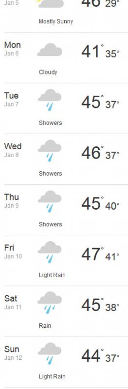

rdm01
Yeah, that is my feeling. Unfortunately, they may be SOL for a while (see image).
