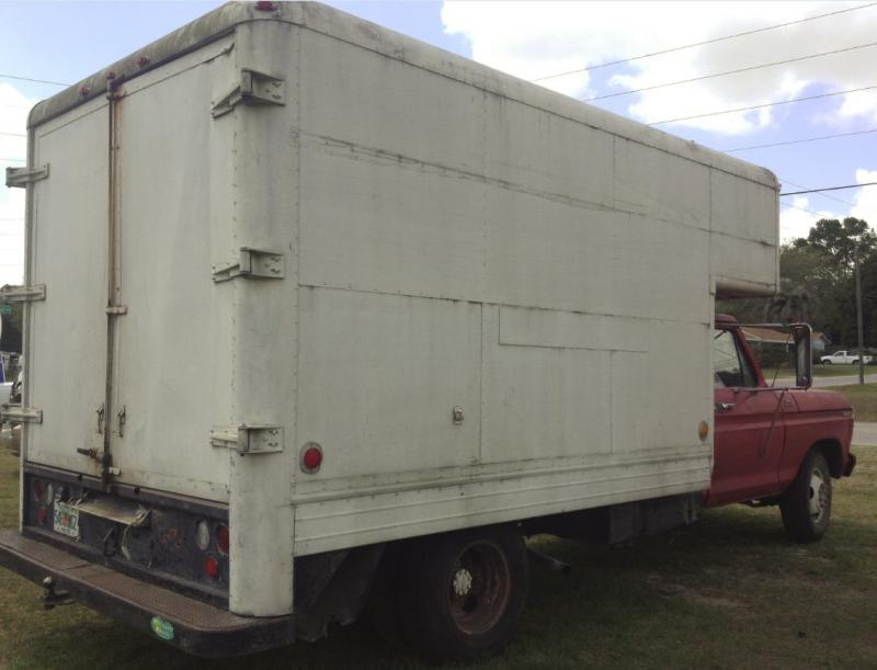

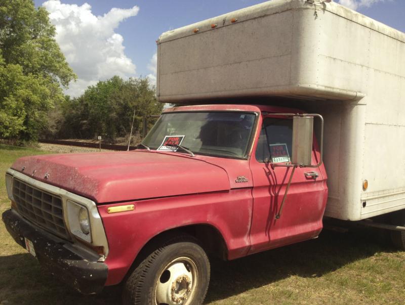

Just received a call about wrapping this box truck. I had him send photos and it's in pretty rough shape. Just the prep work to clean it up will take some work. Rusted rocker panels on the cab. Would a truck in this condition even be a good candidate to wrap?
Three sides each with different company on each side. I think he would be better off letting me throw some aluminum panels on it. Would sure cut down on the labor to prep?

Yes I emailed him back and pretty much stated that might be the case upon me physically inspecting the truck.
Justin
I don't think wrapping it would be a good idea, but you could do vinyl lettering on it. I guess really it would depend upon what you call wrapping. I don't know where you are, but I wonder how crisp the paint is on that truck.. It looks like it could flake pretty easily. Is the guy going to paint it?
MatthewTimothy
also might mention not responsible for any damage to existing panels if removed. I wouldnt be surprised if that vinyl removed paint from his truck either.

I'm sure they weren't questioning doing it because it's an older vehicle, but because the paint is older, faded, and I personally have no idea whether vinyl would actually stick for say 8 years, or whatever the lifespan of vinyl the OP will/would use. I guess like the others have said, do it, and just not warranty it.
OldPaint
do you have any detail shops in your area??? or professional vehicle wash places? this is not one you want to put ANYTHING ON TOP OF ALL THAT DIRT AND CRAP!!!!! IF......they wont bring it to you in ready to apply vinyl condition, TELL THEM you charge as much for cleaning their vehicle........as you do for applying graphics.........that will get there attention.
SignManiac
Talked to him already and he deferred to my suggestion of not wrapping it, especially with no warrantee. Sold him on the idea of aluminum panels instead. It's just not worth wrapping a turd.

Had a guy ask me about wrapping his old uhaul a while back. The box looked worse than the one in the pics. I passed on it and told him, it wasnt worth wrapping and you would see all the damage still. About a month later I ran into him at homedepot and saw that somebody wrapped it. Told me he paid 600 for it all done. Took a look at it and whoever did it, printed on coroplast and screwed it on.
I had to laugh and shake my head.
