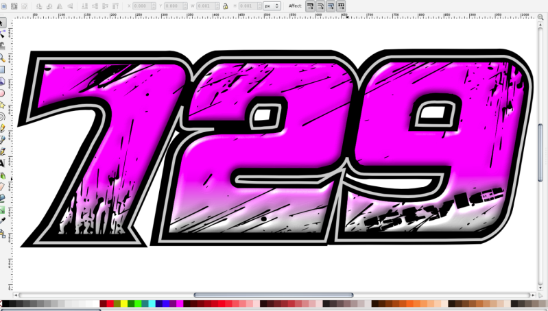

Hey guys, I am new to printing as I have always worked with just cut material, or outsourced my printing jobs.
I am having trouble with I am sure a very simple task and have tried to research but I am not yielding the results.
I am trying to create a cut outline on this image:
I have a Roland VersaCamm and use VersaWorks - I am wanting to cut on the exact outline of the black background of the number. I read something about creating a different layer in AI - but couldn't seem to get it to work. Do you print through AI directly to the printer and not use VersaWorks when completed?
Sorry if this is basic - just need some step by step basics for creating a cut line as I will be doing a lot of these and can use the same process.
Thanks in advance!
Lee

Simple, sort of, in any of these 4 ways:
1. It's a font with snazzy effects done to it. So match the font and you're there.
2. Freehand draw an outline. Shouldn't take more than 15 or so minutes to do it perfectly.
3. Use a vectorization program, weld all the objects it creates, and then node/line edit to clean it up.
4. Open the bitmap in Photoshop, make transparent, remove bounding / background, select the wanted element and create a path from it. Then export the path to illustrator, with about a 0.5 pixel accuracy. That'll get yo close too.
In the case of your example, I think I'd go with option 2.

Thanks guys - I do NOT want any white.....I want it to be printed (pink gradient top layer, gray outline, and black background), cut decal and cut exactly around the black bottom layer so there should be no white at all.
I am using CS3.
Thanks again, I greatly appreciate it!!!

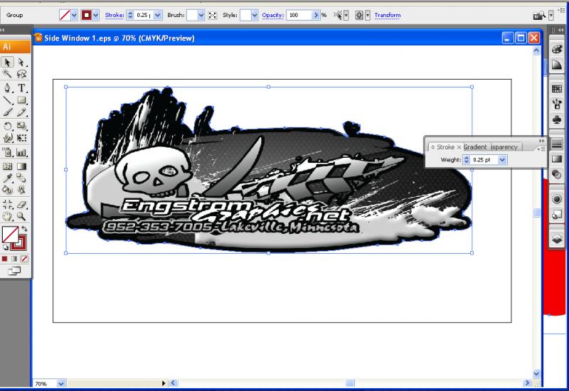

Spoke too soon......thought I had it but guess not. I feel like I am doing all of the steps - but I see the red cut line in VersaWorks, but it is NOT moving, like the ants.
I attached a screenshot to see if anyone can see a glaring problem.
Thanks again guys.

The 729 decal - created in Inkscape, saved as .svg - opened in AI and everything looked good, gradients, etc. Created CutContour and it worked.
Different file - created in Inkscaps, saved as .svg - open AI and when I open it - it is strictly black and white, no color.
So.....I saved the top layer as a pdf. Background (cut layer) saved as svg. Opened both and tried to follow steps to create cut contour on bottom svg layer and never got the moving ants.
I feel it is something with the file - as I did everything the same to create a cutcontour as before - but for some reason when I open it as a .svg there is no color. I did nothing different in the design process that I am aware of.
