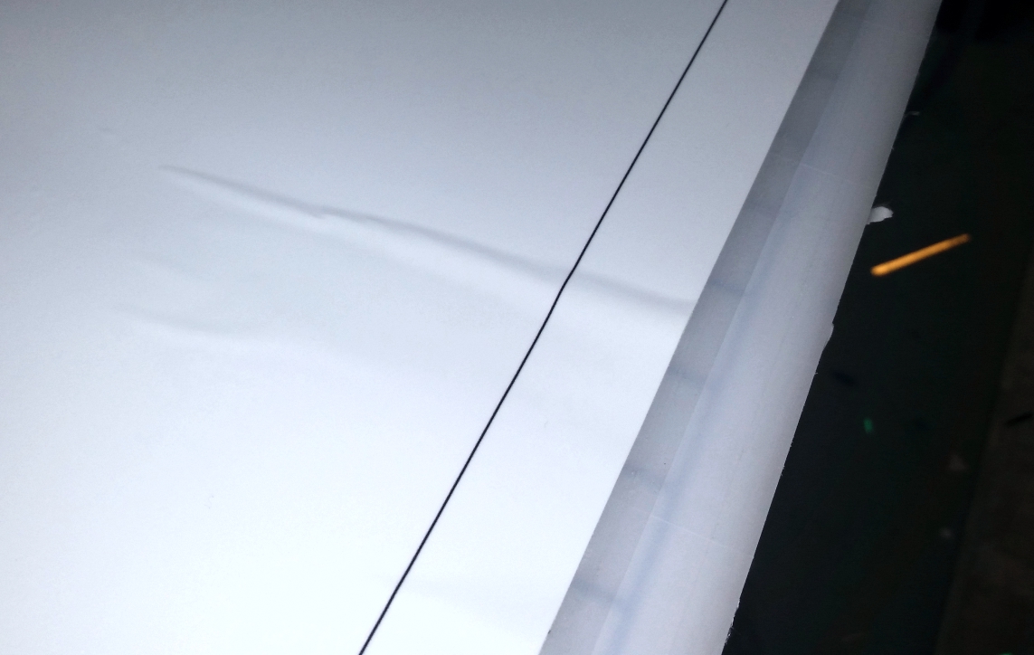

Just printed and laminated our first roll on the L560. After laminating, my production guy said, "Hey, come look at this"..to which I said uh-oh.
It seems to be lifting up along the edges (tunneling). See Pic. Anyone else see this? Shouldn't be a problem once off the backer.

saw it in action at the ISA show, neat stuff. slides around on the panel without sticking, until you apply pressure.
however, I've always been one to wait a year before getting excited about any "new" media. let others do the beta testing for me.
I'm still printing/wrapping with Arlon DPF6000XRP with great success, with zero failures over the past few years.
Yeah, I typically wait too...but it's on special this month for like $850 kit. Figured I'd try it out on some not so vital stuff.
