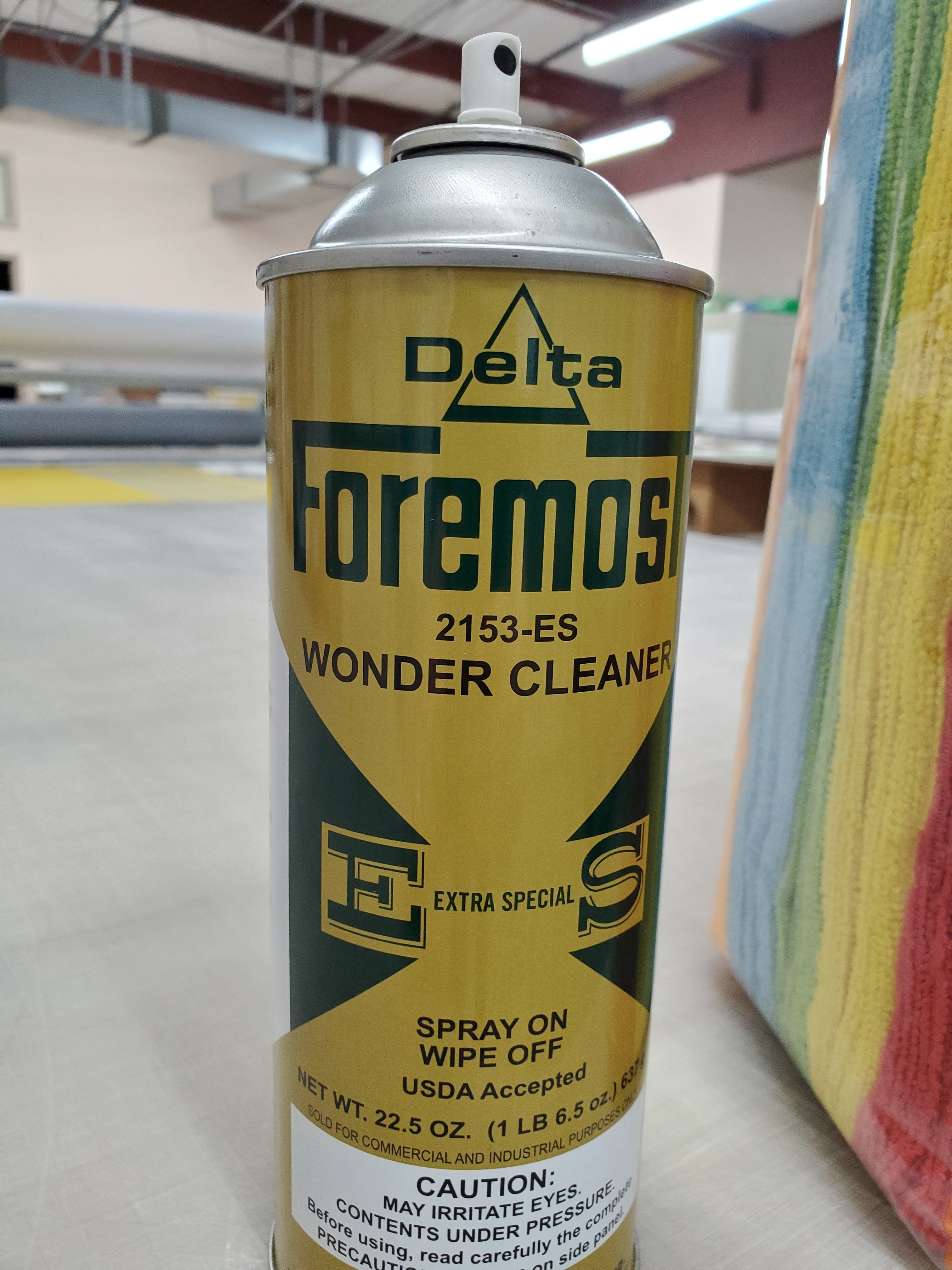

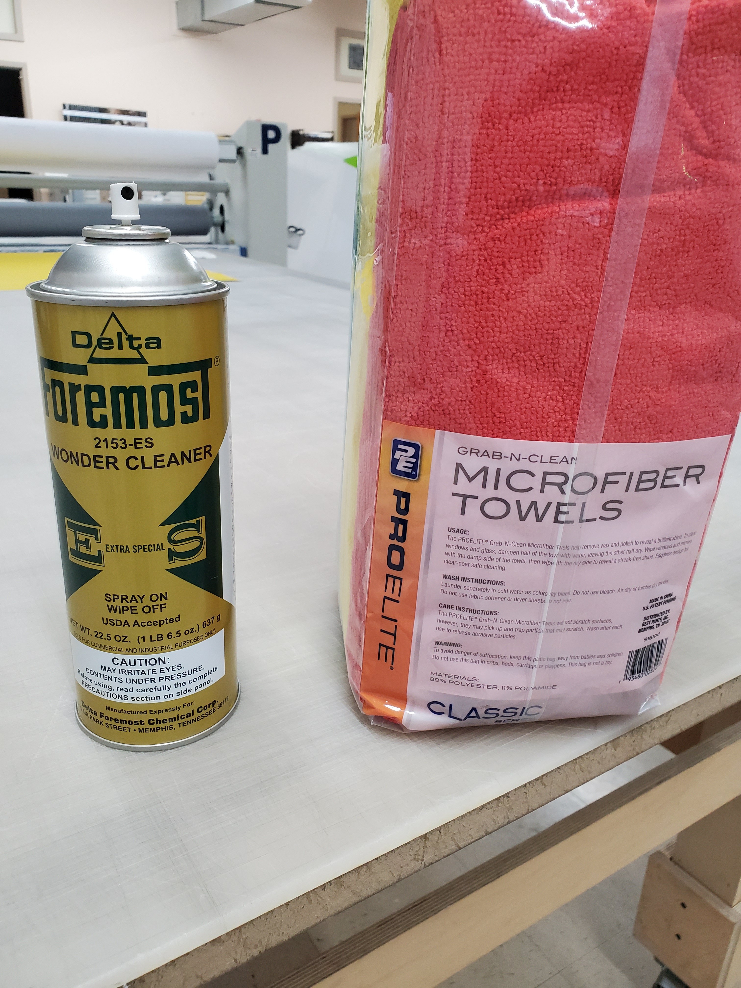

Hey All,
I found what works! We have a cleaner called Wonder Cleaner and, we used Microfiber Towels with it. No streaks or smears!
Let me know how it works for you.

Hi Brandon,
We found that this product works great and, I agree the microfiber towel is a big part of it.
