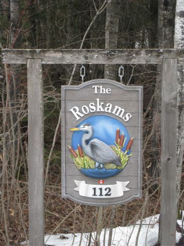

Another completed hand made Sign
piccadillysigns
I love to see the client faces when they see their sign for the first time!

That is a REALLY nice sign...no, it's over the top.! I'm jealous.
Would you mind explaining some of the processes used as you put this together?
OOps!..I have to wipe the drool off the keyboard..
Thanks.
Ken
piccadillysigns
OMG, Thank you so much for the kind words,

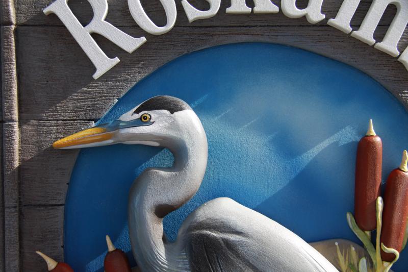

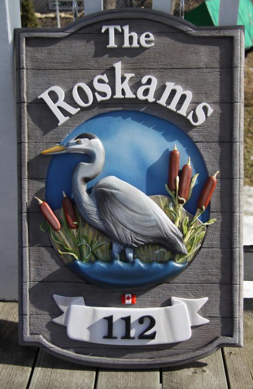

The sign is all 15lbs and 18lbs HDU, except for the Flag & Grass which is epoxy clay.
Our process is done in layers to get a nice clean look, after all the elements are cut, primed, painted, then they are then assembled using pins and PLL construction adhesive,
We have found that the layers achieve a depth in the sign our clients love.
Thanks again
