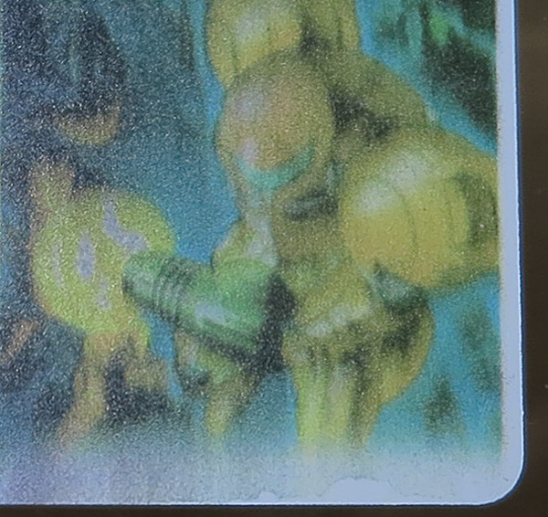

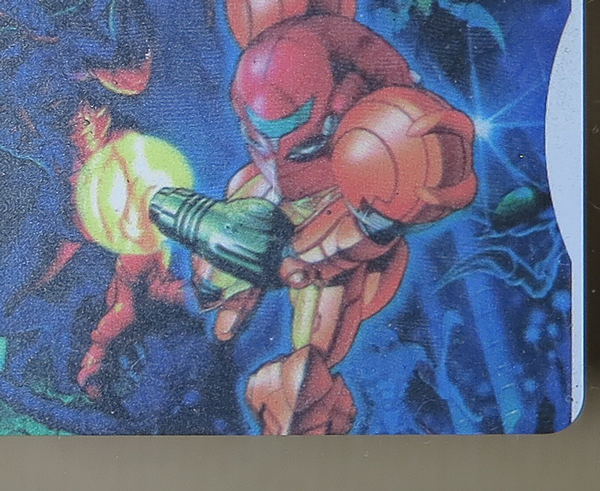

Also I took a photo example of before and after the problem. Notice how the colors are completely off and how the ink is smearing and blurry.. (even after 2 cleaning cycles...)
GOOD PRINT (First ones)
BAD (latest, head manually cleaned, software cleaned..)

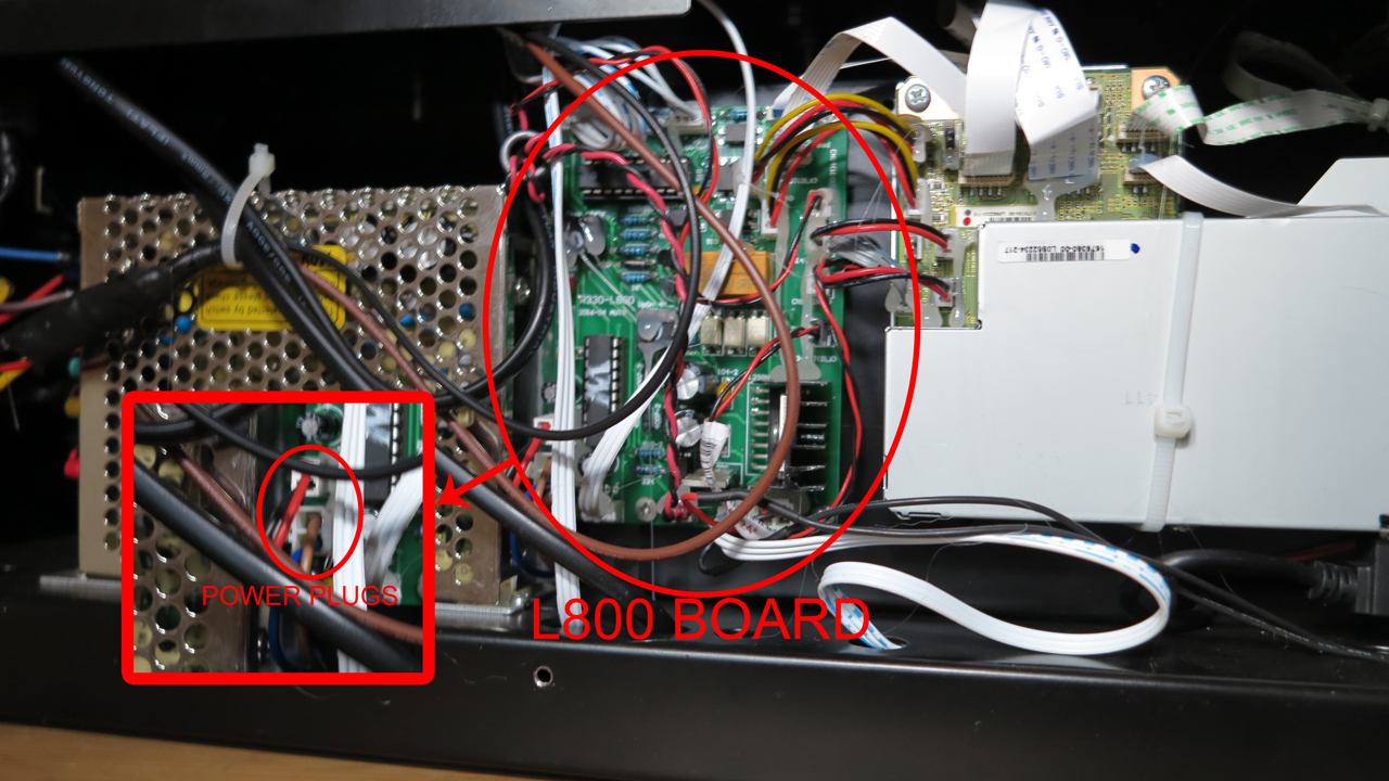

you may not see a button or other recognizable backup battery. you could try unplugging interconnect cables off the power supply board, if you can recognize it. cmos power would be either 5volt or 3.3v most likely. leave the board disconnected for 12 to 24 hours. the only risk i would expect would be losing user settings. this would be safer than inverting a battery. there is always a risk of damaging circuitry when you invert a battety, although we all do it. disconnecting cables would be safer. (inverting battery works faster, though.
you will wait 12 hrs so capacitors on boards discharge to 0 volts
if this works, mark the cables in cse youneed to do it again some time.

Thanks for your advice, I have teared down the "beast" and took some photos of the guts of the machine. I have located what I believe to be the power plugs that link the main board to the PSU. Unfortunately they have glued every chip and every plug of the circuit. It's a real mess to unplug all of this. I have not found any kind of battery, CMOS or watch type... Here's a photo of the area, if you see something I've missed please tell me. Also notice how the mainboard is not an official L800 board. Looks like they've built their own.

It's an A4 format, accepts item as high as 10cm thick (maybe slightly more) It's a good product overall .. but the prints in 1440 and 5760 are like day and night...

you may be able to reset your electronics by leaving it unplugged for a day or two.
(i know each day down costs you money, but there may not be a better answer, at least none that i know)

my thinking would be, i wkuld like to add a couple "test points" to ground,perhaps througha resistor, so we don't do any damage. if this works, a workaround could make the printerr usable long term. a good workaround is almost as good as a fix, especially in the absence of real tech support
