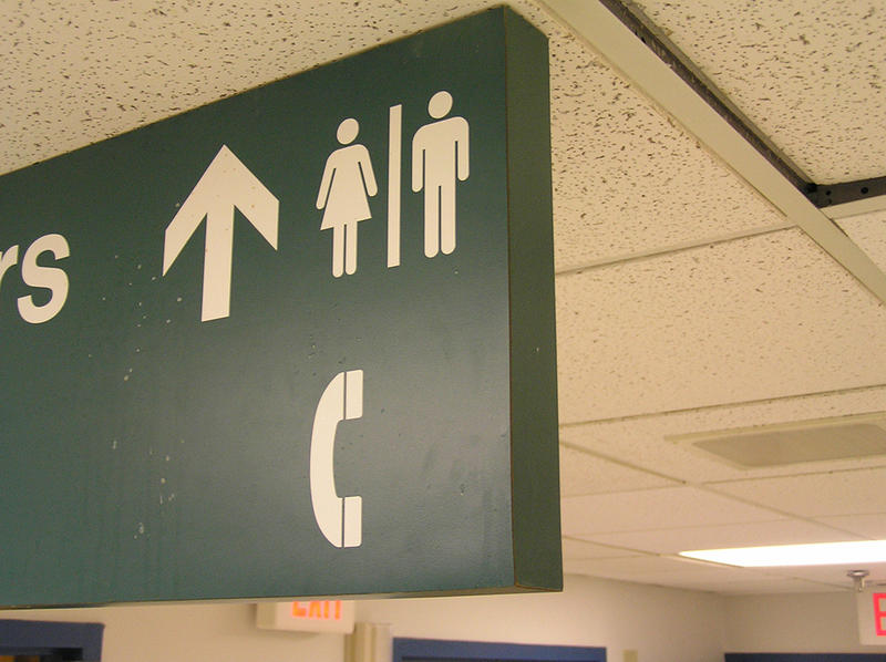

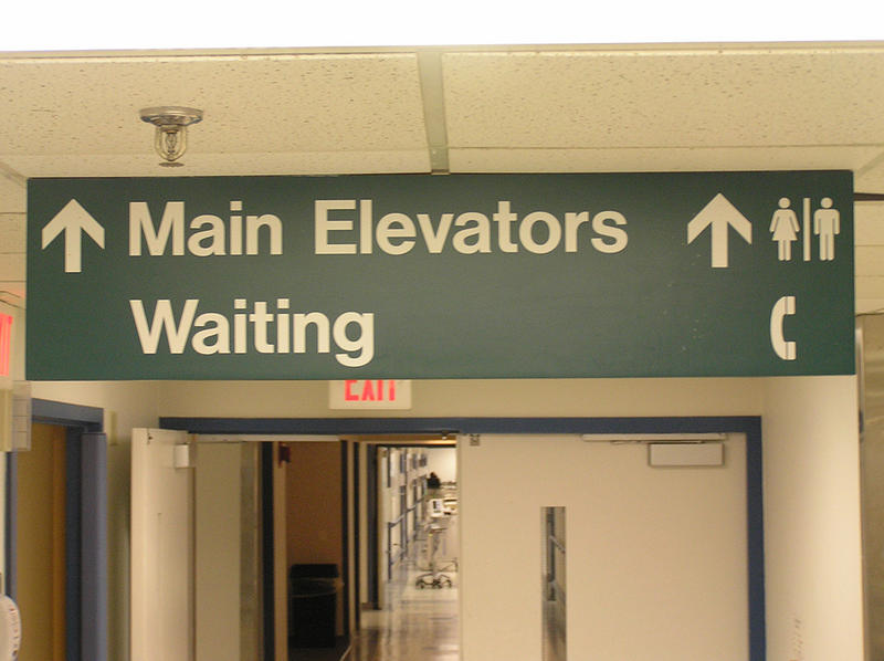

We need to re-create these for a local hospital.
They are about 46" x 12" x 2", hollow, very light weight. It's made of a type of hard cardboard material, but I was thinking of using two aluminum "pan-faces" riveted together. I'm just afraid the look won't be quite right. I can't imagine how these were made. Any ideas or suggestions?

are you sure that is not Formica or similar? the edges have the brown phenolic look to them where they have been trimmed with a router.

Our local hospital uses very similar signage, and they are covered with Formica plastic laminate and then have white vinyl graphics applied to the surface. Looking close at the bottom corner of your photo, you can see the darker core of the plastic laminate which tells me it is plastic laminate (Formica).
The structure is made from a honeycomb core material much like an interior door, with a solid light weight wood perimeter frame, and then the plastic laminate (many colors to choose from), is then applied to the edges, trimmed with a router and a flush trim bit, then the front and back laminate is glued on with contact adhesive, and again trimmed with the flush trimming bit.
I have used flat panel hollow core doors to make similar signage for trade show booths, after I cut the doors to size, I rip some 1x pine and glue it inside between the two surface skins of the door panel, because after cutting them to size the edges have no support, just the exposed honeycomb core. Mine are not 2" thick, the hollow core doors are 1-3/4" thick, then the two pieces of 1/16" laminate, they end up about 1-7/8" thick. See the attached information.
