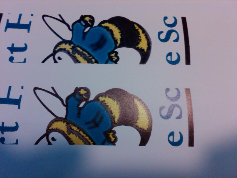

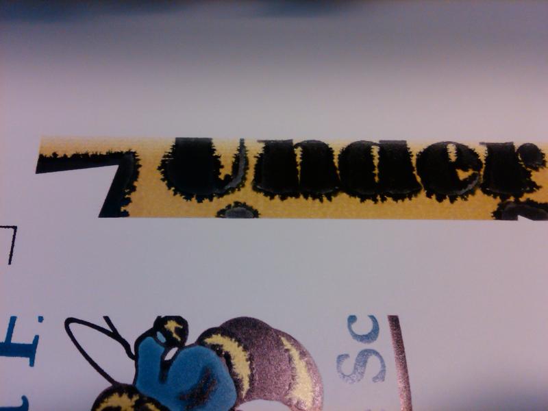

Anyone have any thoughts? Bad media?
So I just opened up a roll of Orajet 3164 Matte and I am trying to print on it with really bad results (see pictures) The yellow and black and blue and black are completely bleeding into each other but if I print solid black type it prints fine.
I printed a job yesterday on this machine on Orajet 3621 Matte and it printed fine.
Is the media bad?

Heaters working OK? It looks like the media is not accepting the ink (cold media) but you said that the black only prints fine? Hmmm

It looks to me like you're printing cold. Can you turn the heat up from the control panel and verify that the platen is supposed to be hot?

The ink seems like it's puddling and not sticking. You need to verify your heat settings through your rip or via the machines front panel. Make sure you didn't change to a media setting that has a low heat setting.

Double check your heat settings in your software.
Sounds like you have it set to "use printer setting" which may be off.
