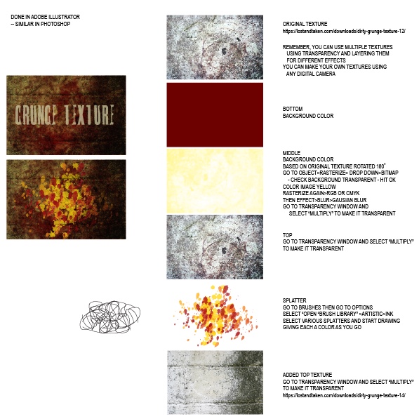

Youtube and a few sites do have some instruction but I made a little how to guide... I had a client where grunge was a big deal and almost every pattern I made was based on the few steps I show here - after a while you get really fast at it...
  • TEXTURE HOW TO.pdf
