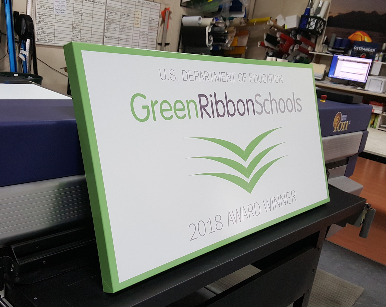

We try to sell clients wanting a "permanent" long term sign on having us make a formed panface out of .063 or .080 aluminum depending on its size and applying either diecut vinyl, hand lettered or usually laminated cast vinyl prints wrapped to the back edge, but never all the way around the back side of the flange.
We really like these types of signs because we get to manipulate the depth of the substrate without needing to use solid material to do so.
Installation is super simple by attaching a length of aluminum angle iron to the wall at the top and bottom inside dimension of the panface and then just popping the panfaace over them and zipping a few screws on the top and bottom flanges through the edge of the sign and angle iron. No visible hardware anywhere on the sign but those couple of screw heads.
Very clean and long lasting.
We do lots of these this way too, but I missed how we got off in to pan signs??
