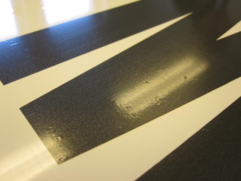

Been doing quite many signs and car jobs by now, still im quite new to the bussiness.

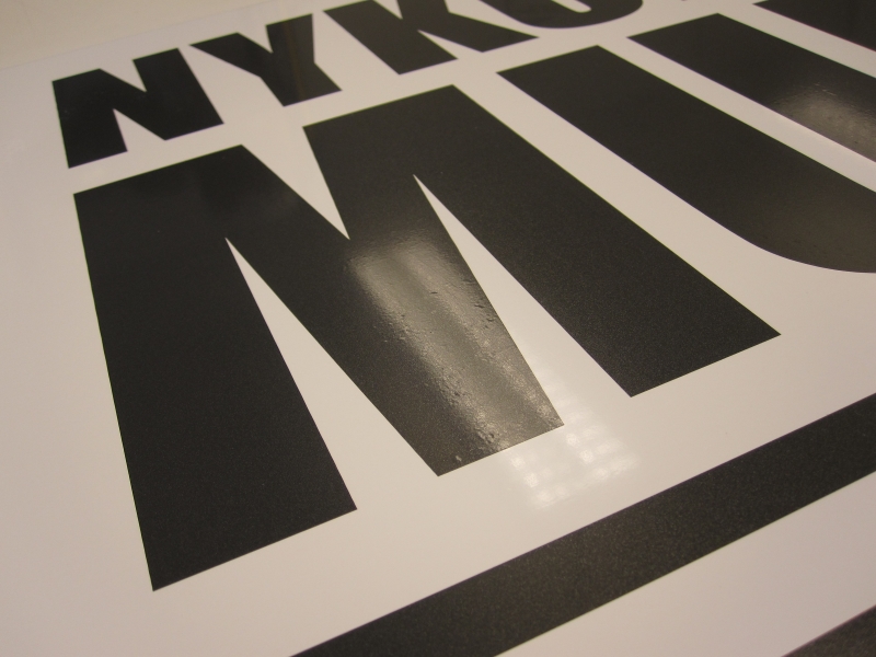

Doing Aluminium signs today. Always applying vinyl graphics using water with a drop of soap. Sometimes i get no "waterbubbels" at all and sometimes it's just alot of them everywhere. You know when you squeege and they just wont go away, just floats around under the decor.. Today im having those problems on the alu signs, used the same material for car graphics some days ago and was spot on. Im just wondering what tips you have for this?
On the attached image i've squeeged for like 5 mins on the same letter "M" and still it looks quite bad, but as i said, it's watermix.
Im also wondering if this water that is still under there will go away by itself by drying a few days or if it dryes in sunlight etc?
This vinyl is the image perfect 5700 series, using R-Tape conform (paper) for application tape. Don't think it's my technique really, squeeging from middle to outsides alot and hard for atleast 5 mins ontop of the r-tape before removing it...
Please help me.

Don't sweat it. It happens. If your customer doesn't object or have the time to wait, they will disappear over time. Metallics, like you've used, tend to do that for some reason I've found. Check the edge of your squegee, too. Any little nicks will end up as bubbles. Could be the soap, too. Never use dish soap or anything with a surfactant in it (ok, caveat: I've heard some guys use Ivory liquid and others Johnson baby shampoo with good results). I've been doing this for almost 20 years and I still have the occasional water bubble stay behind!

i think you need a bit more detergent. I use a garden pressure pack using the cheapest mild detergent i can get. I like the mix to just feel slightly slippery between my fingers. Too slippery & you can't get the premask off quickly, too dry & the vinyl sticks too well.
I like to get the premask off as soon as possible (5 minutes is way too long ) cos then you can squeegee any bubbles you see, using a sleeve of course. wet it first to help removal
Just practise with some scrap & different concentrations of your app fluid. I'm always amazed how a big wrinkly chunk of vinyl floating on water can be squeegeed perfectly flat

Just came back to the workshop, the waterbubbles had flatten out by itself this morning, the whole sign was flat apart from like 2-3 small small ones on one letter!
But i guess better tech will fix this for future work!

The detergent is used to break the surface tension of the water. A couple of drops in a gallon of water is more than enough to perform this task. You should be able to do this job dry.

I've had issues with the soap and water mixture too. Tried out the rapid-tac II to see if it was all that, and what do you know.... problem went away.
I know some on here think it's all a bunch of balony, but hey, it worked for me.
Vinyldog
When I did wet installs my choice was Johnsons baby shampoo - someone mentioned hand softners, anti-streak agents etc. in some detergents - who knows how that effects the adhesive?
On a standard squeegee there is almost always a ridge or crease - use that to sharpen and strighten the edge of another squeegee by scrubing it back and forth against it - a small dink or wear curve in your squeegee will cause bubbles.
