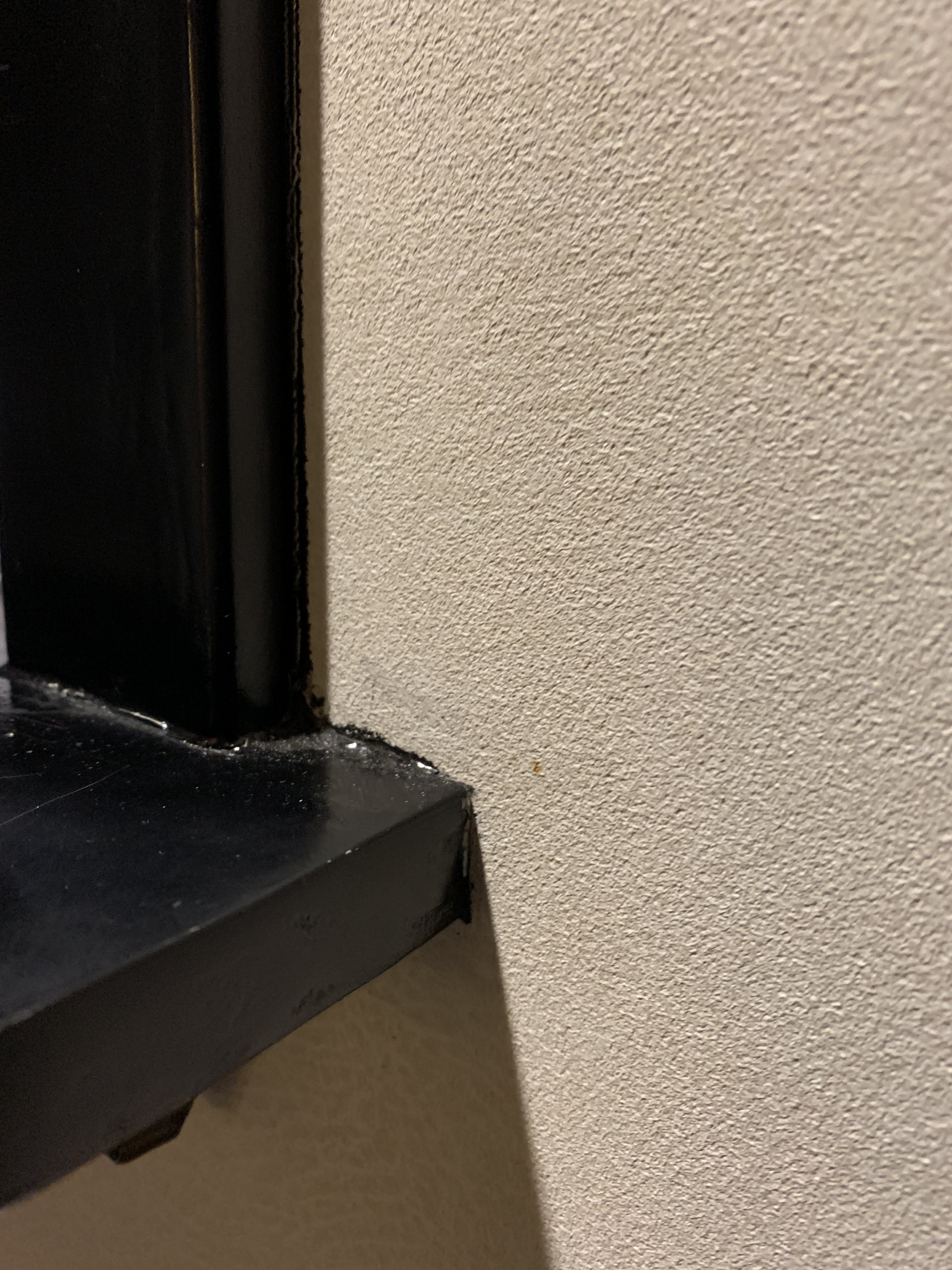

Good afternoon everyone! We've hit a bit of a dilemma in our shop with an installation that went pear shaped. So I'm coming to the professionals. ;)
Here's the job, so far: 3M prints from Signs 365 with matte laminate were applied to a wallpapered wall at the business. It's a large, full coverage area. The wall was cleaned with denatured alcohol as per our usual. Installer is educated and knows what he's doing.
The day following install, client calls and says the vinyl is peeling off. We check it out. On-site decision is made to reapply with a rivet brush and inform the client we'll be back in a day or so to check it out and see what's happening.
Two days later, it's peeling off again. Installer goes out and applies Primer 94 to corners. Give it a day or two and check again. This seems to be working. Installer applies Primer 94 to a large section of the wallpapered wall and reapplies the vinyl graphics that were peeling off.
About a week goes by and we get a call. Now it's staying secured at the corners, but it's "bubbling" out in the middle, meaning there are air pockets. The client is just pressing them back down by hand as they see them.
This is a really good client and they've been very understanding with this for us. We want to fix this problem, but we're not really sure where to start. I don't want to order the prints again, and have the same problem.
What I know about the wall: there's a picture of it attached. It is at least 10+ years old in its current state (with the wallpaper). It was thorough cleaned before the vinyl was applied (each time it was applied). We've used this vinyl on hundreds of other installs without an issue, so I'm assuming that it's not the problem.
What you need to know about the design: it has to be printed. It's a distressed font word collage with multiple colors.

Dan360
We use texwalk (or similar) on textured stuff like this. Will stick to just about anything and you don't have the same problems as vinyl when it comes to textured walls.
I don't think standard vinyl is gonna cut it since you won't get full adhesion on that.
MikePro
+1 textured wall issue.
I assume by 3M prints you mean ij35/ij40?
ij180 MIGHT be able to heat & mash to conform to the texture, if that's what is installed then try to hit it with high heat and a foam roller.... if its ij35/40, or any calendared vinyl, then I wouldn't bother trying to "make it work" because it will only get worse.
If it were me I'd be attempting to use either a high tack vinyl for LSE plastics like arlon8000 that has a thick gooey/sticky adhesive that can grab onto the texture OR a textured wall wrap vinyl like 3M 8624 that can thermoform to the texture BUT would try samples first before committing to either.

Just before I posted this, I thought of the vinyl that's used on concrete blocks. We don't do that in house and sub it out. We did one for this same client last year and it turned out awesome. Just not sure that's in the budget. Yes! Definitely doing samples before printing the whole wall again.

In my old shop, we had painted wall paper much rougher than that, I put printed wall paper over top of it... I had to apply the wall paste on pretty thick & squeegee the excess out, but it worked perfectly & covered all the imperfections.
