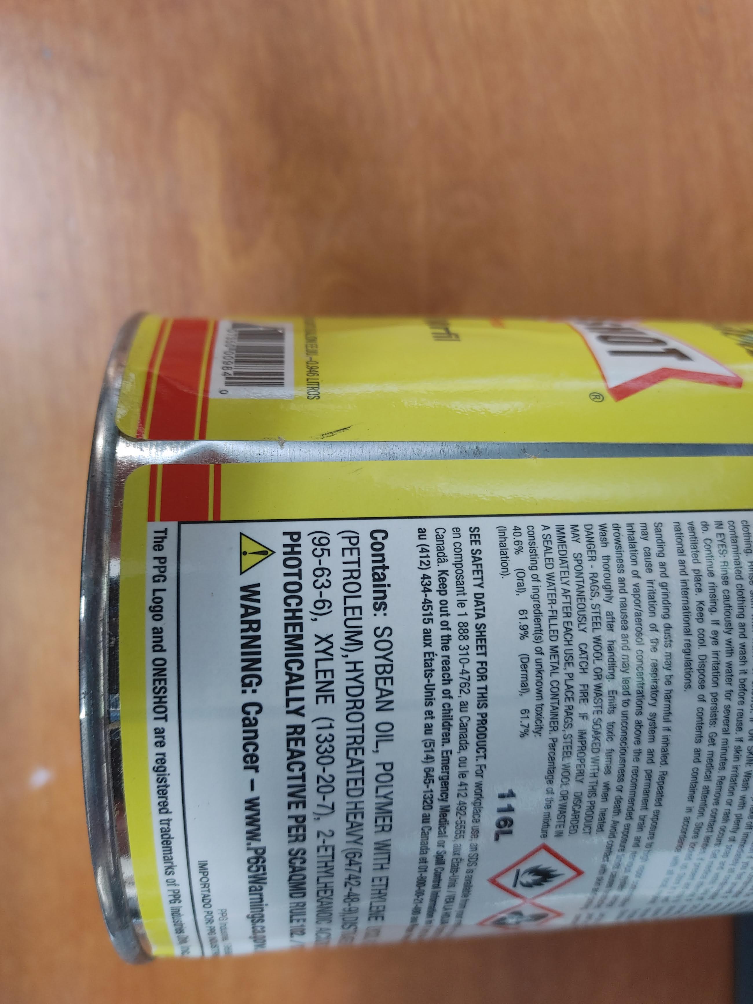

Here a picture of a can i received about a month ago. Some of my other cans have A Spraylat company, but they are years old.

I do not think we are on the same page. I have been using the "small can method" for 25-30 years. No problem.

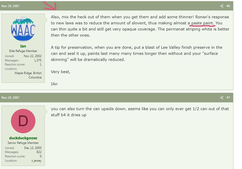

Look at this thread......Ian is mentioning the same problem as well. The "paste paint"
