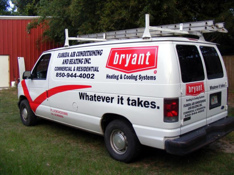

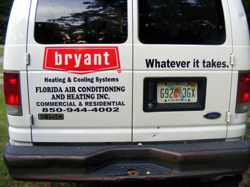

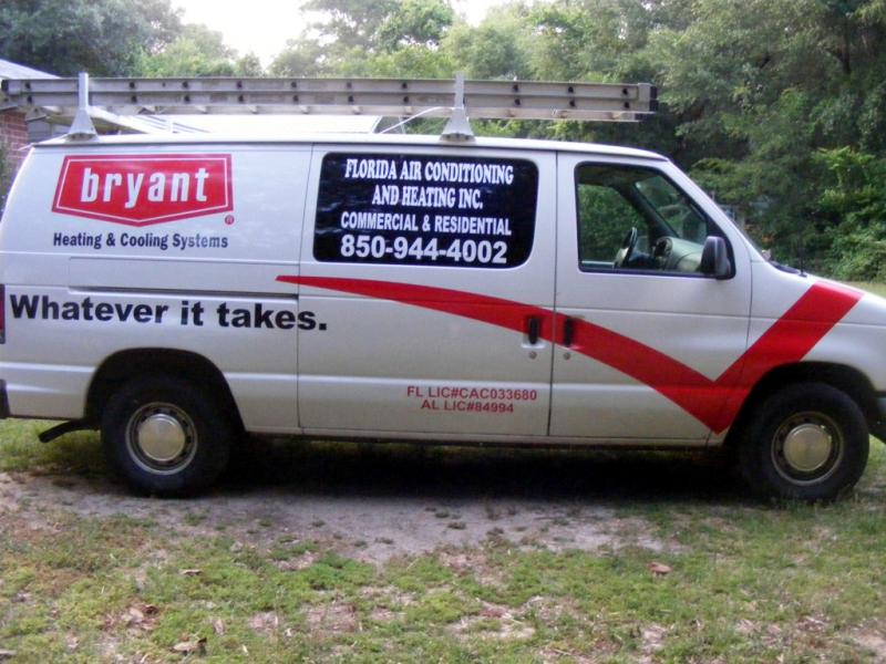

aspent the weekend workin....
OldPaint
I spent the weekend workin....
its an older van 2000-2001 done with shinerite............

Nice job on the van Old Paint. All these young guys who complain will be copying your style in a couple of years and calling it "Retro".
thewood
Well, he's using calendared vinyl on a vehicle. So, at that rate he will be copying his own work over again in a couple of years!:wink:
Just kidding, OP.

jsmoritz2000............YOU DONT KNOW WHAT YOUR TALKIN BOUT!!!!!!! of course its 2 pieces, well REALLY 3.......
1. from hood to bottom of door
2. THE DOOR
3. THE TAIL))))))) LOOK REAL CLOSE AND YOU CAN SEE WHERE THE DOOR OPENS)))))))
HulkSmash
Shineright might last 6 months before it starts shrinking.
Other then that, he didn't do a crooked install. He just decided to install it level instead of follow the body lines.

BUT..you are right on how i laid the vinyl.........I DIDNT FOLLOW THE BELT LINE...as it is wider near the front door and runs up hill to the back of the van. also the roof line does the same thing.
if you measure the hight on the upper panel on these ford vans, near the front door it is 24", at the back of the van it is 22".
its better to "eyeball" to level then follow truck beltline.

What ever it takes on the drivers side doesn't line up either. It was put on in two pieces.
2. THE DOOR

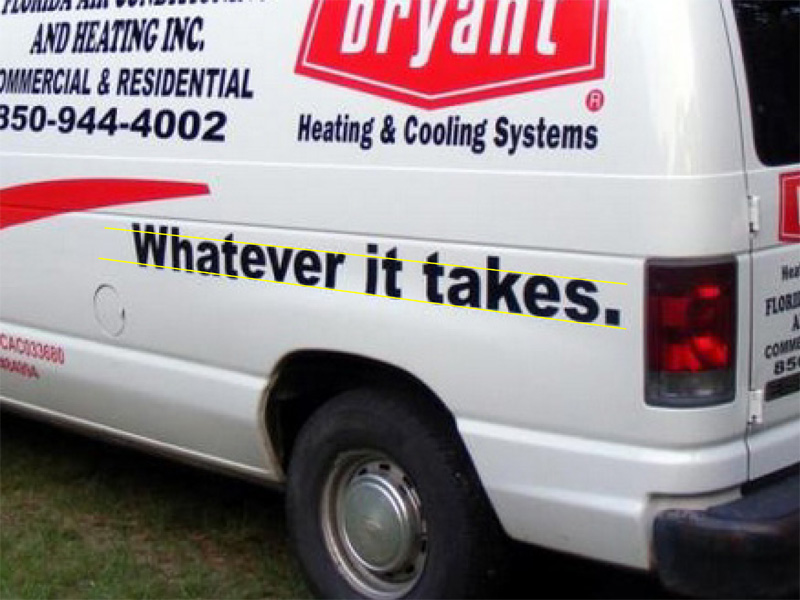

I'm sorry, but it is you who does not know what I am talking about. Allow me to illustrate.
Ouch....... !!
I think he caught you OP, but honestly, the back doors look the same. Looks like your software skipped a beat like your heart did. Gotta check out that skittering around on your plotter. :rock-n-roll: Glitch in the software perhaps........
