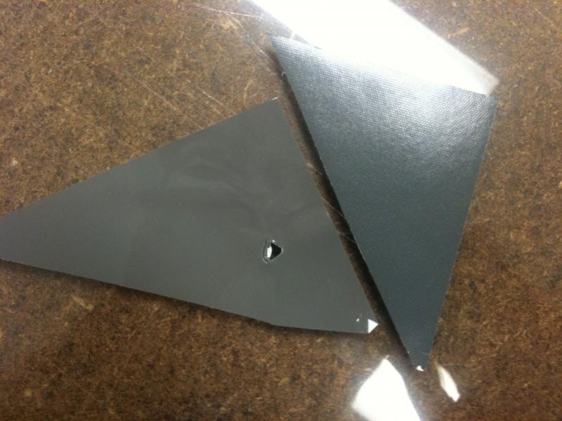

You've been sent the old 1005 FLEET which is now MPI 1005 SC LTR your vinyl I'm guessing doesn't have the hatch pattern on the adhesive side?
The face films are the same so they will print and look the same but you won't get bubble free or slide ability.
You want the MPI 1005 SC EARS film.
jasonx
Took a photo for you.
The one with the hole is LTR hasn't got bubble free (old 1005 FLEET).
The one on the right is EARS has the bubble free.
You can see the difference in the colour.

Yeah I'm hearing you. Been through that prob before. This is gloss ltr ez rs. Straight off the box. Apparently a new code. Adhesive colour is def different and does have an air egress

Thanks for taking the time to post the pics. Appreciate your help
