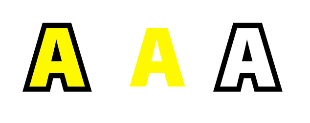

You need to make sure that you cut the yellow area's out of the black...
If it was me I would add a about an 1/8" outline to the yellow so when you overlay the black you don't have to be 100% on your alignment.
Like this...

I think I get what you are saying...So then the yellow would over lap the black about 1/8"....I appreciate you advice and help. So what would be the pros and cons if you laid the yellow first and then laid and overlapped the black? I would assume same result just slightly different look.
cgsigns_jamie
Personally I'd lay the yellow first then the black outline. This would allow me to do like a "color trap"
I usually add a 1/16" or 1/8" to my bottom layer (yellow in this case) then overlay the outline. That way if I'm slightly off in my alignment I won't have any white showing.
I've attached a wireframe of that "A" (I changed the yellow to red so it'd be easier to see)
Also I like to use the 3M 3630 series because of the clear synthetic liner makes alignment 1000 times easier.

Lay the yellow first, then the black. Be sure to hold it up to a light while you insall to make sure it looks the way you want it to.
What ever the outline thickness is, say .5" make your yellow a .25" thicker.

Or just print some crosses in each corner to act like registration marks, then pull them off after the fact. Anyway the yellow needs a bleed over the black.
Mosh I don't understand why I would print some crosses when we are not even talking about doing any printed vinyl. Also if you laid the yellow over the black being as it is translucent wouldn't that change the shade of yellow in those areas because the black behind it would make it look darker. If you but the yellow down first then the black, black is black so if it looks darker it wouldn't look as out of place.
