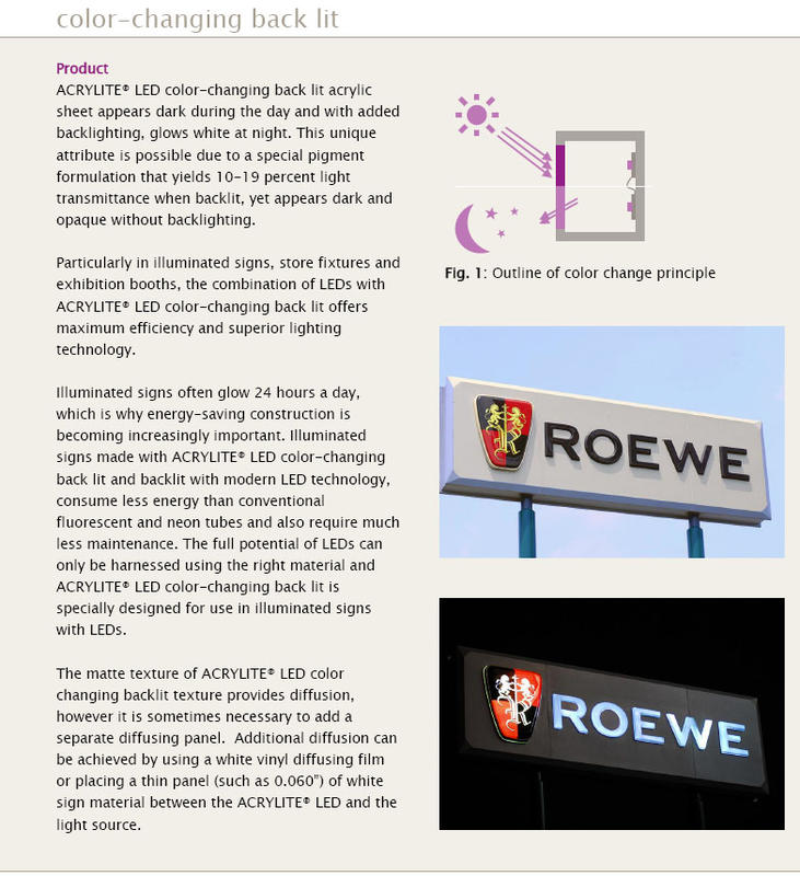

there also is an acrylic that does this. it's been around for a long time and I think it was used for some JCPenny stores in my area. we didn't make thme so not sure
Yeah, we have used that too, but I don't like it, it's a dark gray during the day and a muddy light gray at night.
