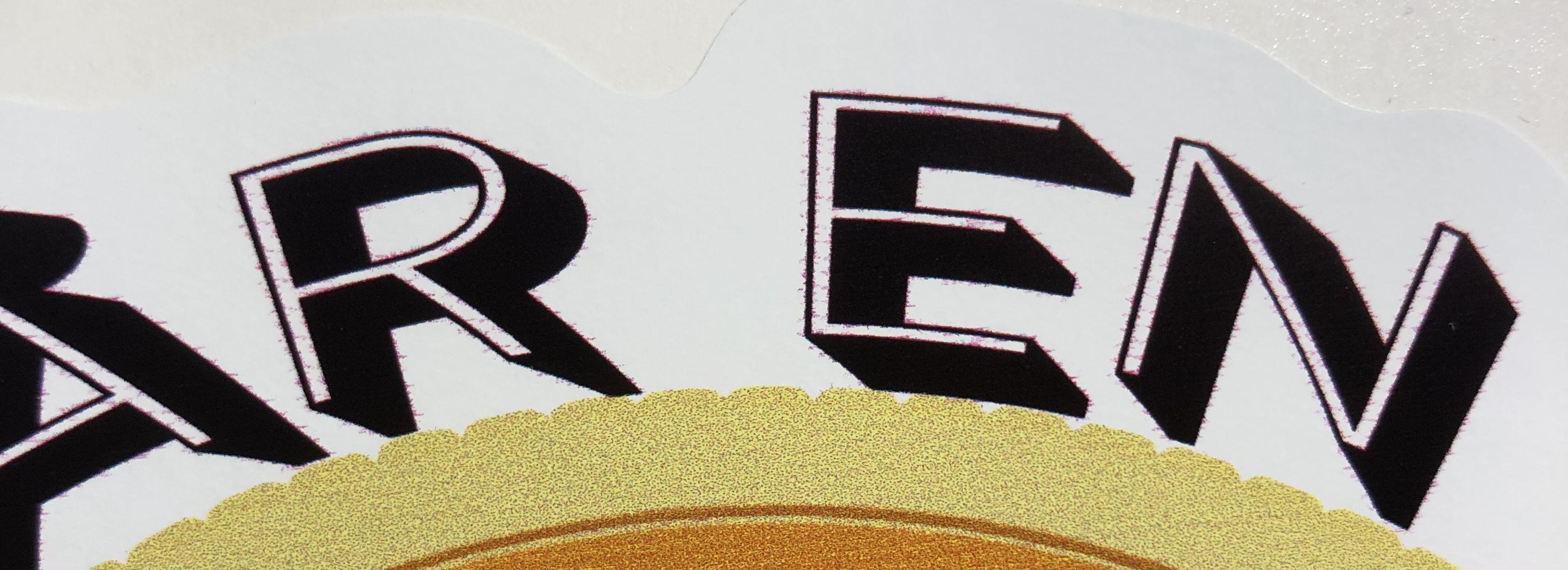

can you help me again? all of a sudden my roland started making a red line around the decals. head alignment is still good.
the red "line" on the decal only EXIST if I make a black square. for example, if I make a yellow or red square, there is no red line. I post a picture below.
