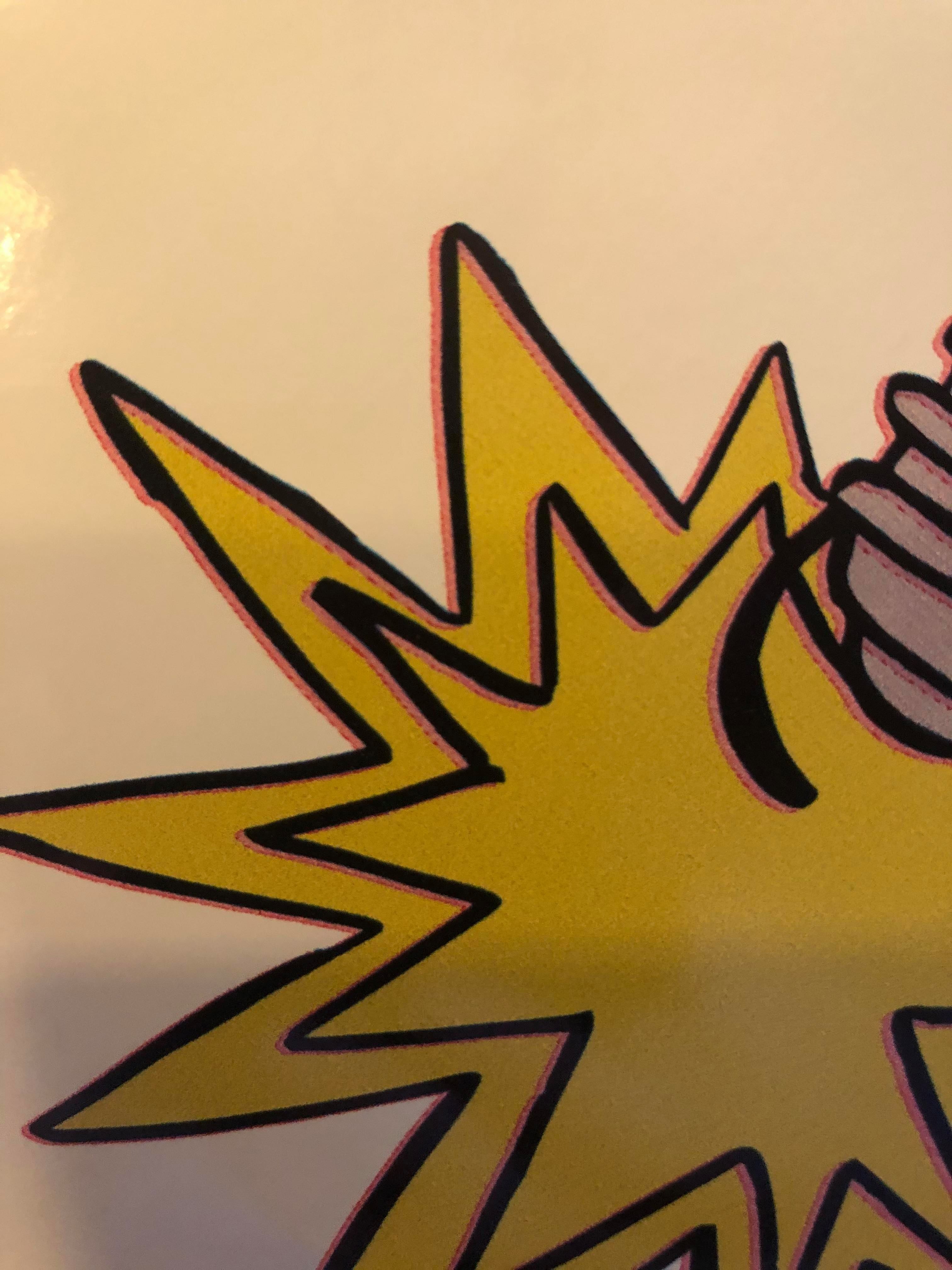

why do I get the red line in the printout? it is an eps file, the color is otherwise good.

The picture is taken on the first print I made, bought the machine without printheads and has fixed it. All other prints I make get the same red line. Have never used a roland or versaworks before, can it be a setting?
Johanswe
I now see that if I write a text in illustrator, the red line is not included. but if I download a vector and print, I get red lines.
Johanswe
That may be due to the way your illustrator is exporting, 100% black ink will not have this issue since it appears to be the magenta being misaligned. What you are seeing is the magenta head laying down ink that should be mixed in with the other colors to make a rich black...
Okey. How fix this?

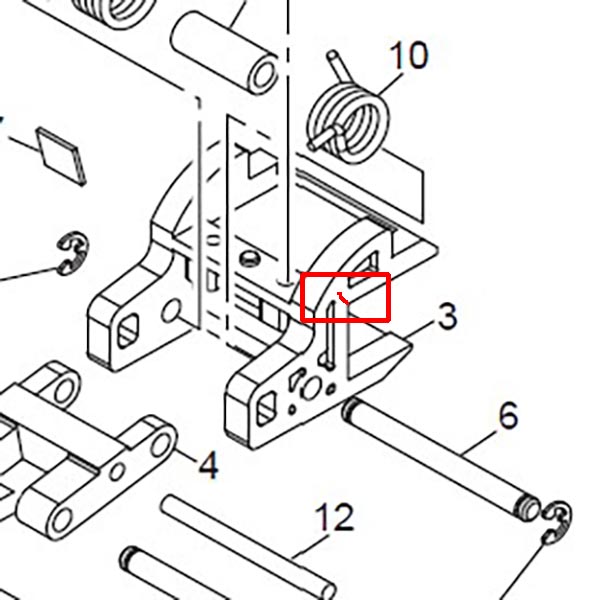

Look at the sides of all the pinch rollers. The outer 2 rollers should have a colored dot on the outside, i.e., the left roller should have a dot on the left side and the right one on the right side. The middle rollers should not have any dots.
Look for a crack in the pinch roller assy - see attached pic.
Perform the following:
Initialize the limit. See attached file.
In service mode: Linear Encoder and Linear Calibration.
  • Initialize the limit.pdf

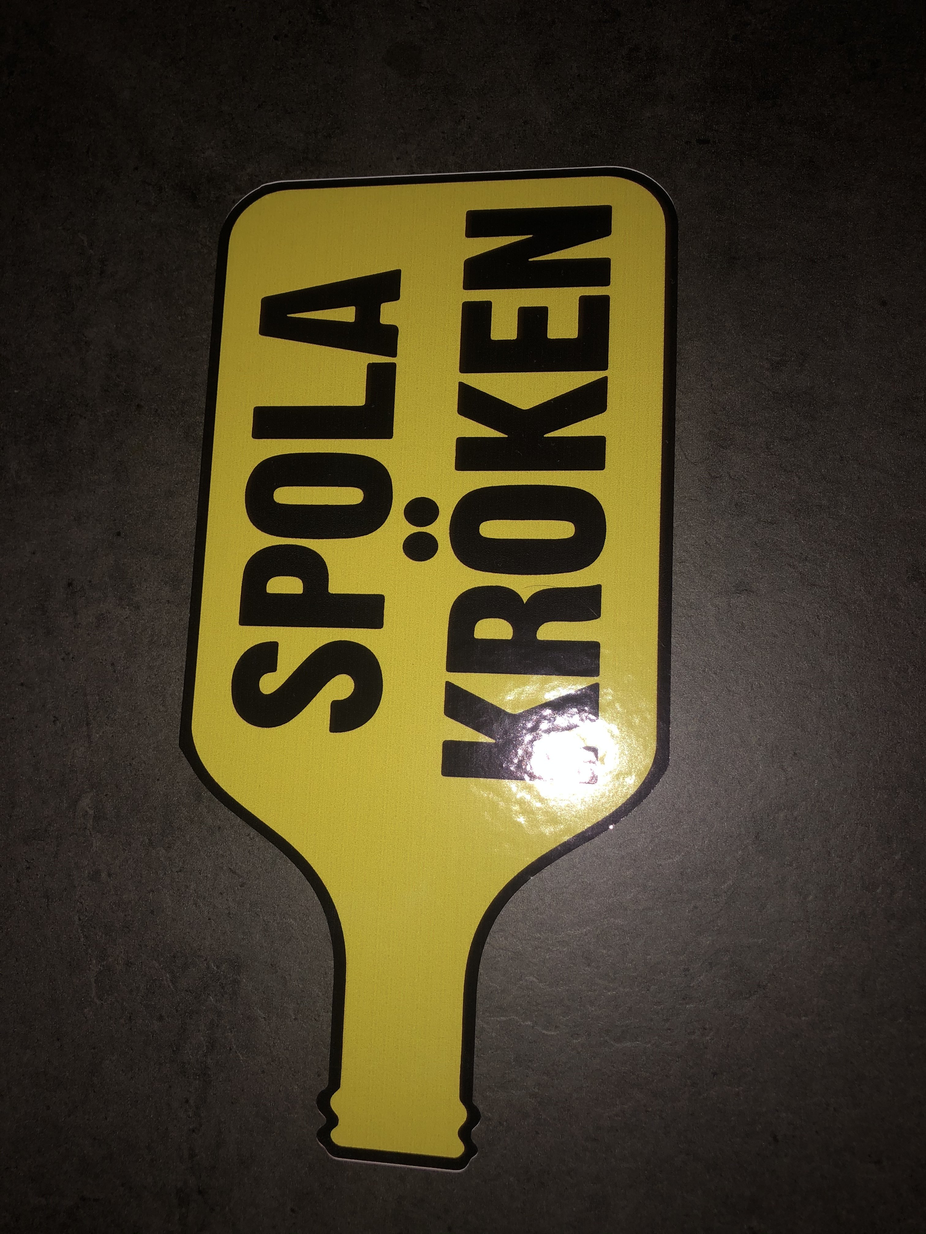

no crack on anyone. can it help when I get media flanges so I can attach the vinyl behind? run loose sheets now. And i did a different print than the black squares, guess this is the problem with the cut? see picture. how fix this? to explain a little better, all the decals are cut differently right now, some more to the right, some more to the left. has received 3 of 20 decals that have been correct.
Johanswe
it is perfectly cut up and down, but the sides are wrong.
How can there be offset on both sides?
