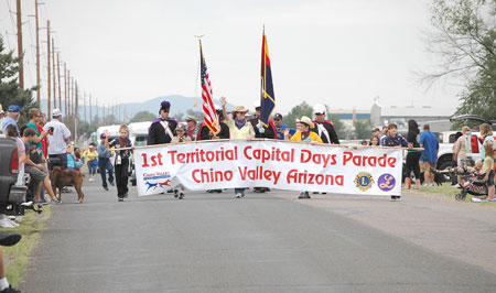

We've done a couple parade banners for the first entry to carry to kick off the event. It is 3'x17' and is usually carried by the local boy scout troupe. We've just made a standard banner with grommets every 2 feet and zip tied it to a piece of rigid pvc. They do have troupers in the middle for support.
