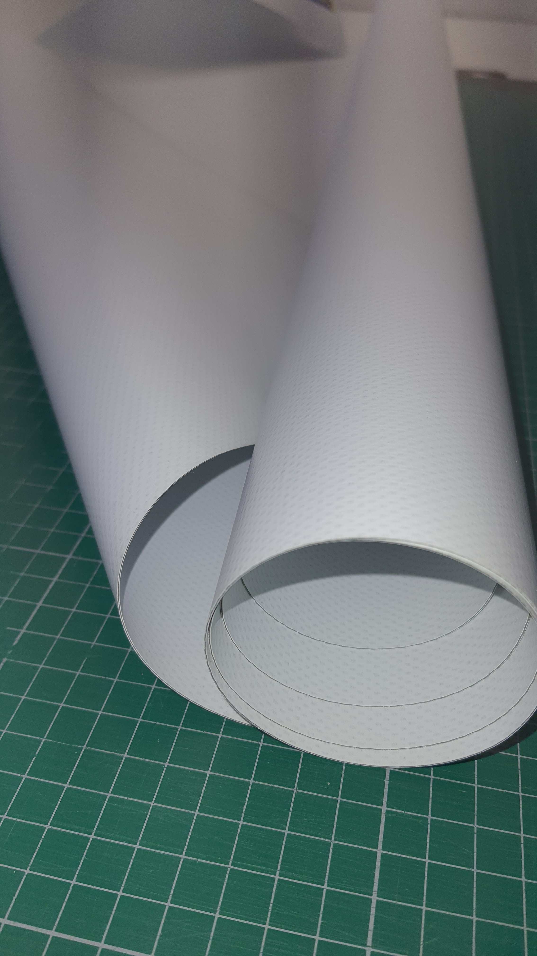

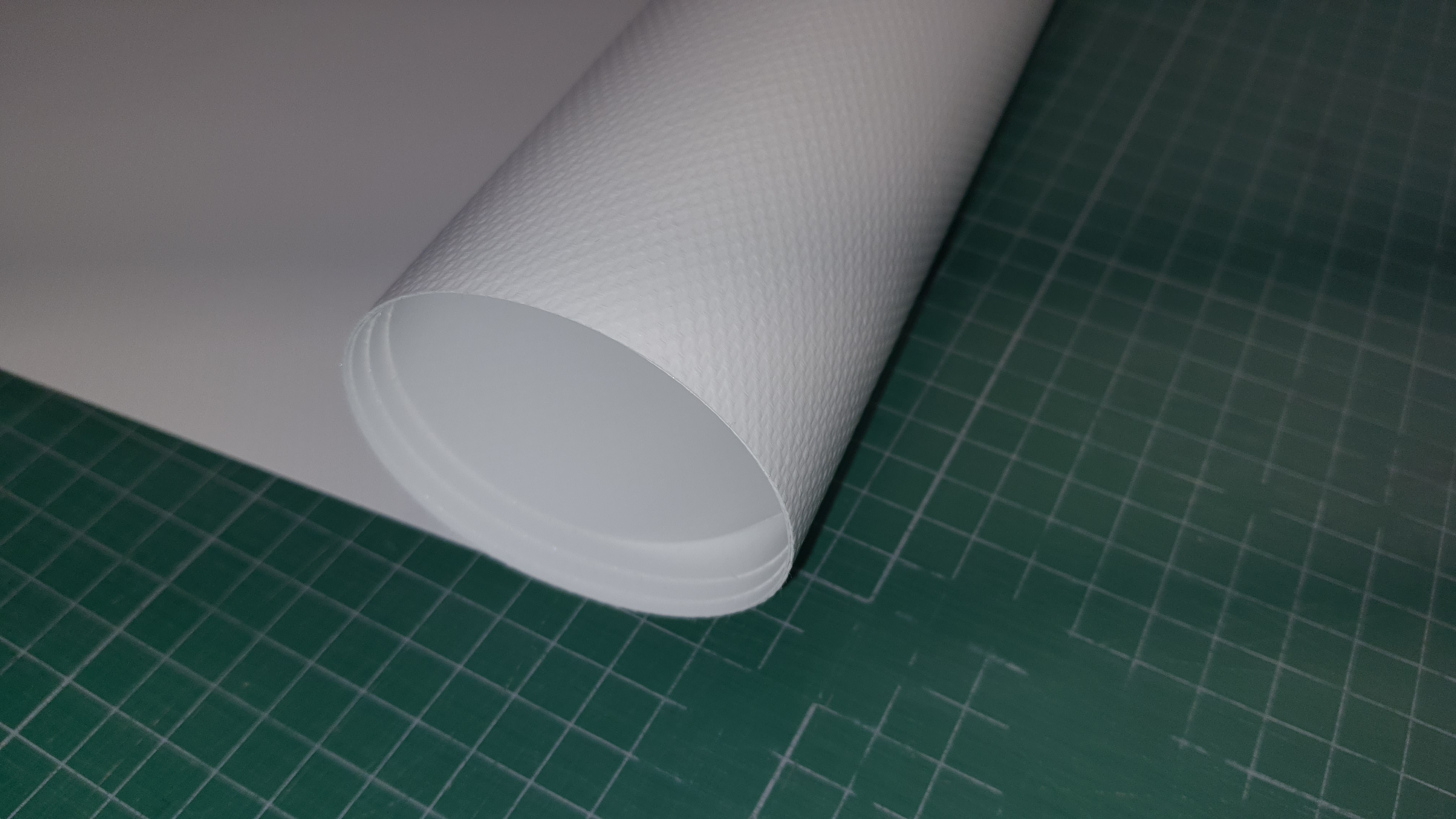

i managed to get semi-gloss... will test it today...
what am i using? maybe we just name it differently...
i name it banner... its a 250g or something pvc material... it is in blockout version also.
