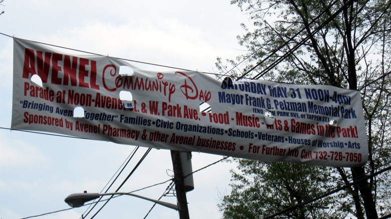

If you need to put slits per customer instructions just make sure they're "Smiley Faces" not "Frowny Faces"

J Hill Designs
I can't laugh, when I was just starting out about 20 years ago I did the same thing
We all did, but that doesn't make it any less funny.
It's only people coming here being told not to do it, that have the experience of all of us, that still do it.... or question it.
