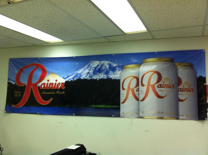

Just finished up a few of these banners. 3' x 10', printed on 13oz. banner, tape hemmed with grommets. Used the Onyx Sign & Banner plug-in prior to printing... saved me lots of time in finishing!
Quality is spectacular on this printer! Blues are super rich, reds are nice'n'deep, and overall contrast is great! :thumb: If photo is a bit fuzzy... it's my unsteady hand shooting with my phone!

Looks very nice Tim.
Any issue with durability of the ink? Scratch resistance?
And do they come out dry to the touch right away?
They're quite durable and yes, bone dry right off the printer. They were trimmed, and finished within a half hour of coming off the printer!

We're done a ton of banner work on the L25500, great machine for quality banner work though for simple cheap banners we still do 4-pass on a JV3.

Hi Sue! The banner material I use is Ultraflex Superprint Plus Gloss 13oz. I generally stock 38" x 164' as a majority of the banners I run are 3' wide and this allows me to print a full 36" and have the 1" hem without trimming the length! I haven't run one in the last two days, but I will do the alcohol test when I do. If I have time today, I will run a little one just to try this and report back here!

Ok thanks! Just was wiping off some dirt on a banner we did, used alcohol... and it like smeared all the dry ink.. very odd..

Ink was cured... Dry as a bone. i have no explanation why it's doing it.
